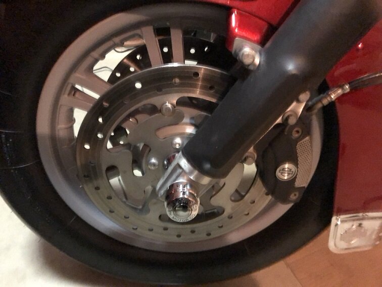

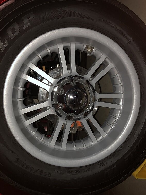

I had mine powder coated a year and a half ago. Took the "naked" wheels to the shop and in a day and a half got them back looking just like an OEM on a new car showroom. Three wheels: $270.00. I've been looking for a pinstripe artist to accent them for me but most of them are too busy at rallys all summer, and they don't want to have the TG sitting their shop all winter. It will happen; someday!

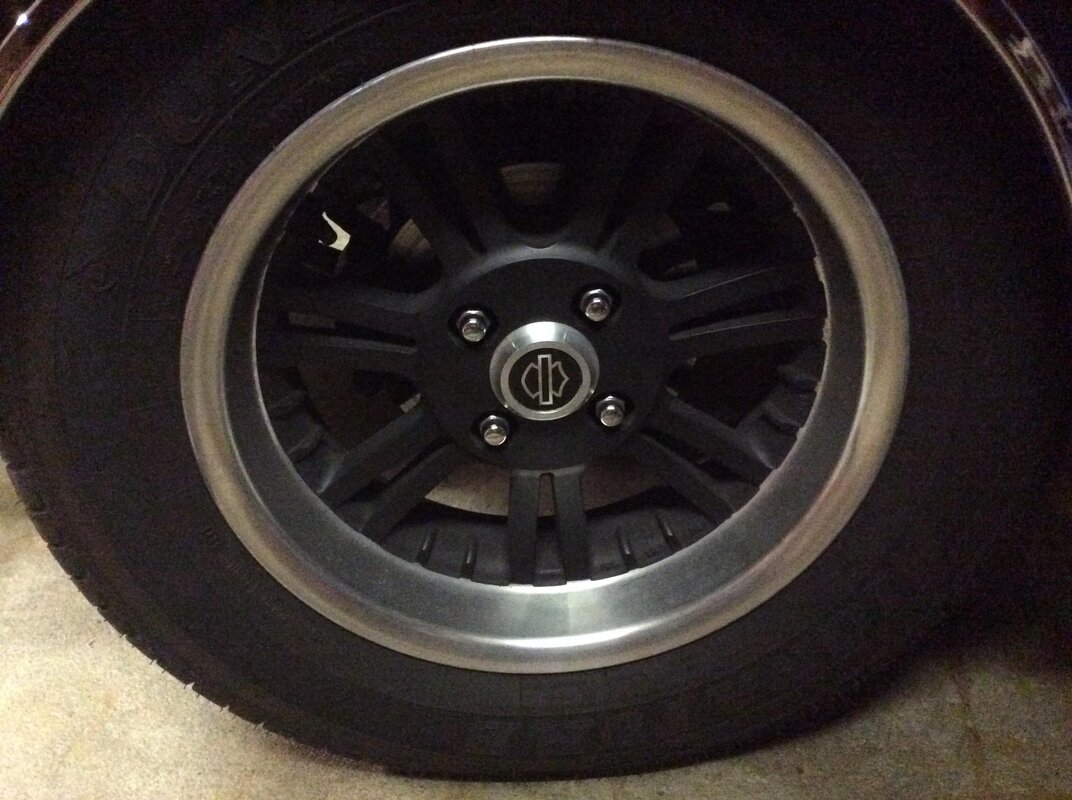

Got a rattle can of Rustolium paint n primer . Scotch brite then dewaxed them . $4.75 Going on 4years since done .View attachment 85392
Looks great. How many coats did you do? Did you do the backs also. How about the front wheel - do you have a photo?

Did not do the front , as it is OEM that way. Just scotch rite the bare aluminum rim yearly.
2 coats on rear wheels , did not do inside.

Had mine done almost three years ago. Banks Engineering in Grafton OH. $270 for all three. They had sixteen colors to choose from. All I do is run a microfiber cloth over them and they're clean! Still have another complete set in polished aluminum in the garage.

I had mine powder coated back in 2016. I left a strip of original rim along the edge so the powder coating won't be chipped during wheel replacement. Second, I had them cover the bottom of lug holes, so the lugs can be torque down without chipping the powder coating.
