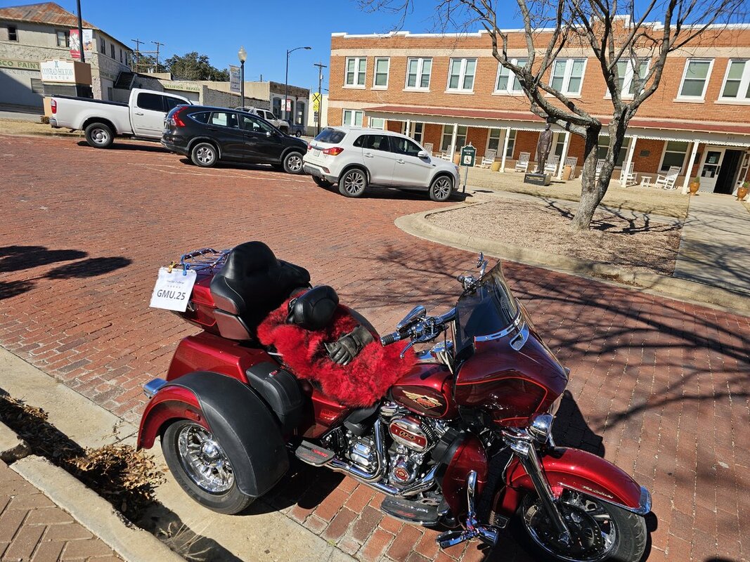

I have a 2023 TriGlide. Traveling at highway speeds of 65 to 70 i average about 150 to 160 miles for a 6 gallon tank. That's on average of 25 to 27 mpg. With tail winds i can get 30 to 32 mpg, 24 mpg for stiff head winds.
I have a 114 ci with a SE Stage 2 (torque cam) with SE tuner, Vance and Hines pipes. I am not heavy on the throttle, using granule acceleration up to shift points at between 2800 to 3000 rpm.
I have DK Customs wings, tank lift, oil filter relocation kit, Jagg oil cooler to control heat. With those mods the oil temps today (88* air temp) was 160*(dipstick sensor) and head temp was 295*.
Cold tire pressures are 36 front and 25 rear. It is just me on the trike. I use the trike for long distance primarily.
It seems, to me, that my fuel mileage numbers are low even by trike standards. Am considering dealing with heat some more with Jim's fan and external breather. Also a switch of Dyna Vision.
