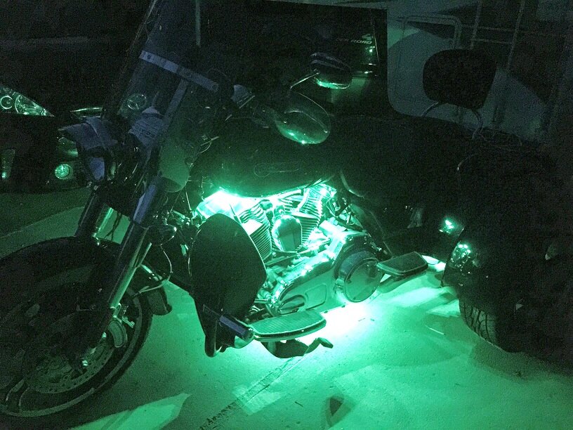

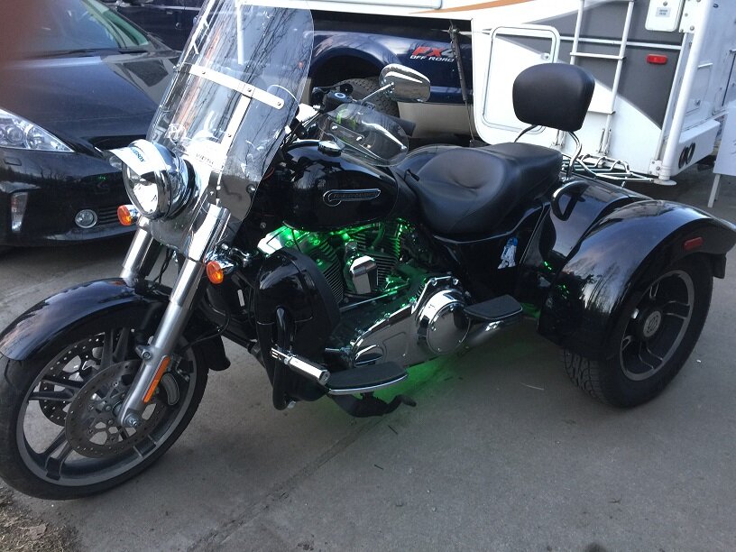

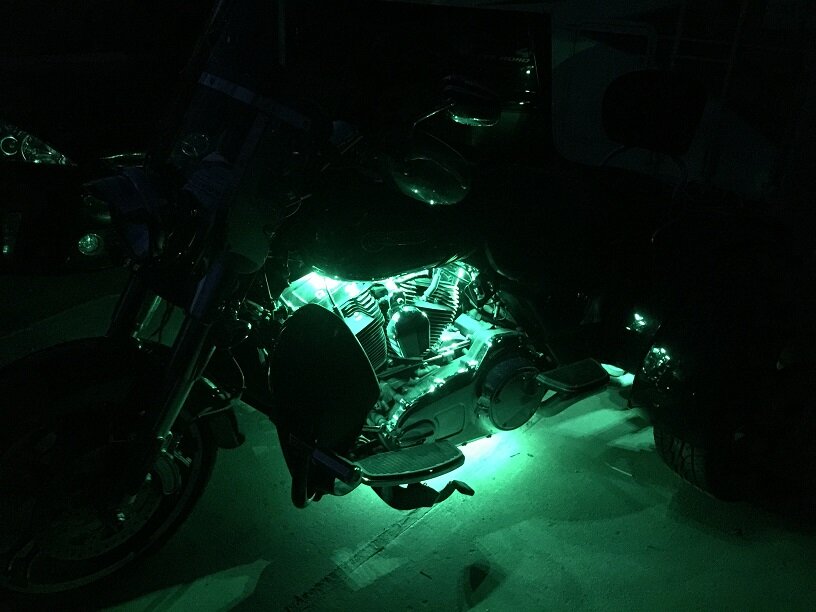

Got me the XKglow kit installed finally... Green is just default, other colors adjustable with the app. I think round two will need a couple more pods under the fenders. First shot is Daytime normal... second shot is nighttime normal... third shot is the second one enhanced to see more detail in the bike.

Looks good. I've seen a lot of trikes and 2 wheelers with underglow multi color lighting. Use it sparingly though. The novelty can wear off if they are on all the time.

Yes, the kit comes with a wifi router type unit. the little grey box, when powered up, transmits a low range wifi signal, that my iPhone attaches to (keeps it wireless)... from the free app, I can change the colors, strobes, breath, and link in my iTunes, and have the music fluctuate in solid or multi color, to my music. I'm very impressed with the product, and it turns a lot of heads!!
