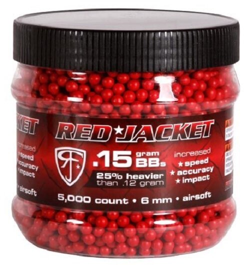

I was looking for something else and stumbled across this writing I made in 2014 of an experience using Airsoft "Red Jacket" BBs to re-balance the 4 tires of a 1992 Thunderbird Sport. That car has P225/60-16 tires, I thought some might find it useful information for trikes on the rear. There is no question in my mind after several tires, it works perfectly ever5y time in a motorcycle size front tire. As a note, I have used them in other tires, like 70 series on the trike rear, Avon Cobra front Trike radial, my 1200's MC tires had them, my trailers too, even in larger quantity (6oz.) in 31/10.50-15 tires on a '77 F-150.

I stripped all the weights off the wheels, all total there was maybe 5 ounces on all 4 wheels. These Goodyears usually don't take a lot of weight, they are well made tires that just get beat up a lot in use. After mounting each tire to it's wheel I weighed out 4 ounces of those same "Red Jacket" 6mm 0.15 gr Airsoft BBs and poured it in from the top side between bead & rim using a small funnel before airing the tire up. Then after seating, let air escape while get core ready .... then insert core and re-inflate to 40 psi each today.

Since my tires today were pretty close, just not quite near as perfect as I wanted, I applied "bead balancing" to the '07's 275/55-20 tires by taking them off one at a time and breaking the bead loose on one side only (I made a bead breaker years ago) and poured in 3-1/4 ounces of Air Soft Red Jacket hard plastic .22 cal BBs in each (used a postage scale), then reinflating, remounting, etc. I know there are bead balance beads that can be inserted through valve stems but I already have a couple containers of these BBs. I left the other weights alone as I was just hoping these BBs would supplement them in a positive manner … even though these are low profile tires.

Thank You, I think they'll be fine. Plastic survives for eons in a land fill they say? Some of what I used yesterday was some that I had used a small "Shop Vac" brand car vac to pull out of tires I had them in in the past, I just pull them out with a narrow nozzle (adapted copper tube) inserted in the tire after the top bead was popped loose. Stand the tire/wheel up, beads roll to bottom, stick tube in with vac running, beads go up tube. I had put them in a screen bowl (colander I think they call it) and rinsed some lint (likely picked up in the vac container) off and let dry, then I seen they still look new, so just put them back in original tub for reuse.
Really, some had thousands of miles of use and are all are just as perfect little plastic balls as new ones. I have seen some say bio degradable ones will powder, but these are not biodegradable, they are a solid hard smooth plastic .22" (actually 6mm which is closer to .236" ) diameter ball. No seams, not like cheaper ones at all, not hollow either. They are in a light tight enclosure too now, safe from being fired into targets. They are called "Air Soft", but they are not soft. At 0.15 grams each, 30 grams to the ounce, 3.25 estimated ounces is about 97.5 grams or about 650 of these BBs to freely spread their balance magic where it may be needed at every revolution of a tire as they move to react in opposition to every jerk of a heavy spot.
The charts often say to add 1 ounce of bead media for every 13 pounds of mounted tire/wheel weight. At 3.25 ounces I added, it should be enough for 42.25 pounds, but my truck's tires weigh 41 pounds (Pirelli says) without the wheel, but then they were pretty well (not perfect) balanced before I added the 3.25 ounces supplemental free moving weight. If I were counting on the BBs alone, I would have put at least 6 ounces in, maybe even 10 as the excess will self balance anyway.
