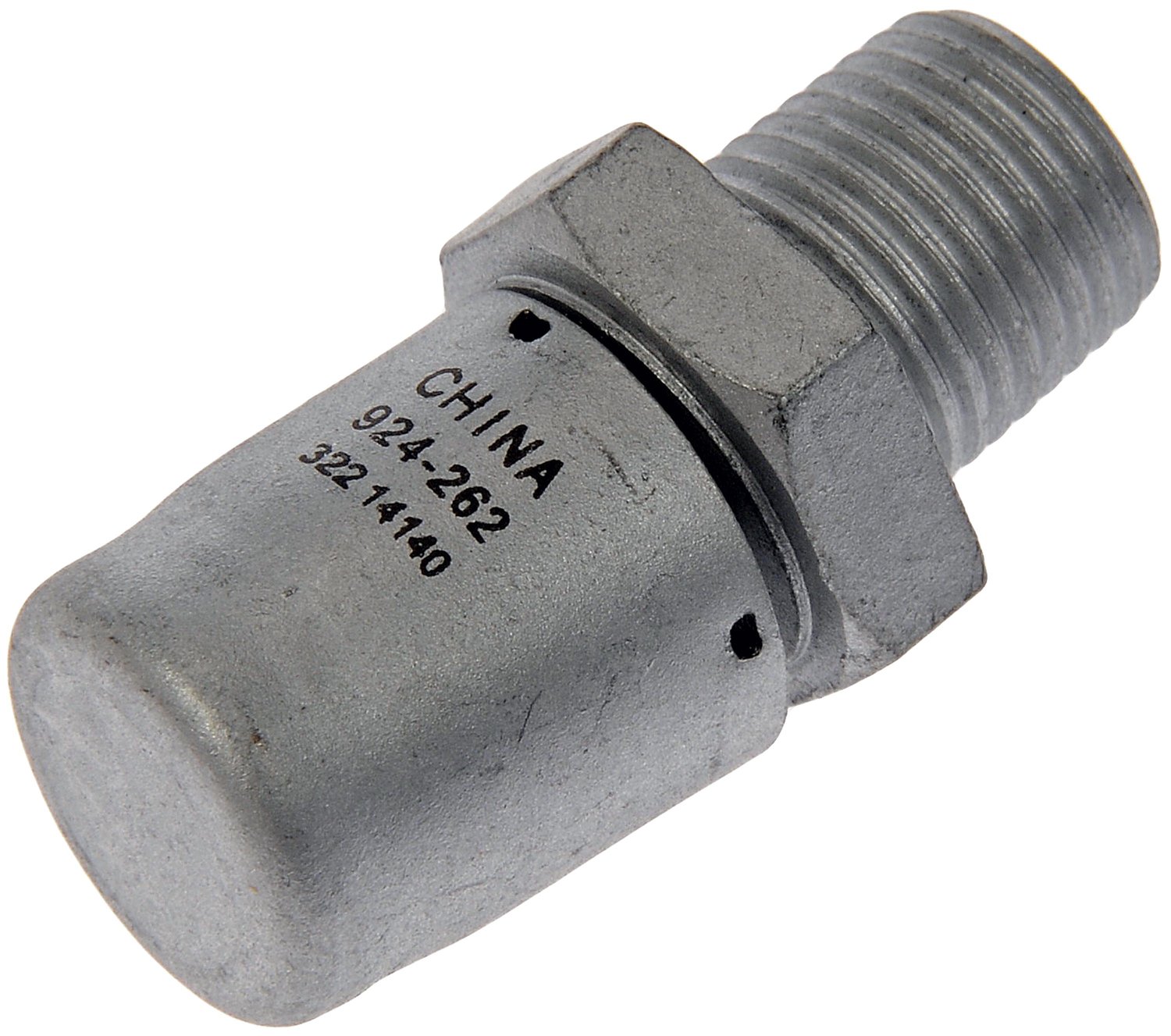

does this look like the vent?
Pinion Seal Headache AGAIN :(
No, that's what l was expecting to find as well. But the one on mine isn't removable. Instead it's pressed or somehow fastened into the differential. It has a small cap that is somehow crimped on, that is also very stubborn to remove. It does move freely though & seems springy if you push on it. So l don't think it's frozen, but maybe it has some sort of blockage?
Understood. Many are a light press fit. Some are even plastic. GM has used that type for years. While it is possible yours has some blockage or the valve is sticking some, if it were my ride I would rip the hat off with a twisting motion and put a hose on it. WE did many 4 wheel drive trucks like that for years. This would give you peace of mind IMO plus a better venting system ( less chance of water and dirt intrusion plus more volume for more pressure venting) Good Luck and keep us updated
