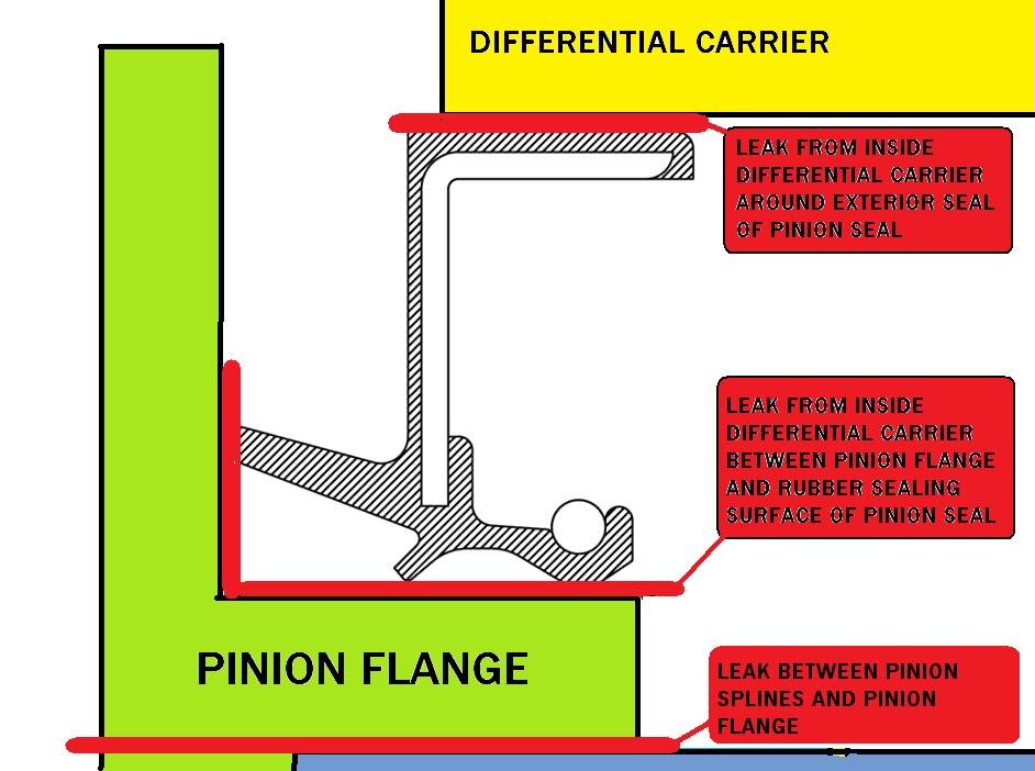

Trace, I think we are using different terminology when naming parts, we talk past each other.
Typically a pinion leak is in one or more of three areas;
between the pinion shaft or stem splines and the pinion flange splines coming past the pinion stem nut; between the pinion rubber seal surface and the contacting pinion flange surface;
or between the pinion seal outer shell and the differential carrier.
Damages to any of these sealing surfaces and insufficient sealing can produce a leak.
Other causes are cracks and gouges in these surfaces as well.

Hello again Jim, thanks for your help on this & the diagram as well. I'm not sure where it's leaking at other than it's coming out of the front where the cover is over the large nut. When l get back home l'm having a different person try to see what the problem is. Hopefully this time it can be resolved, thanks again!! Trace :)
