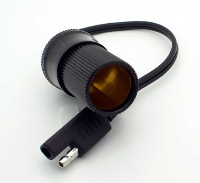

My bride will only be charging a cell phone or MP3. Big end of USB goes in adapting gizmo and other end in phone or MP3. The cables from the battery tender going to the battery are fused and the connector is water proof; when it rains, doubt the new USB gizmo will be used.
I have a cigarette lighter outlet as of today in my map pocket right next to the audio in cord. I can charge my MP3 player or run a GPS from there. I think we have it covered! Thanks wg

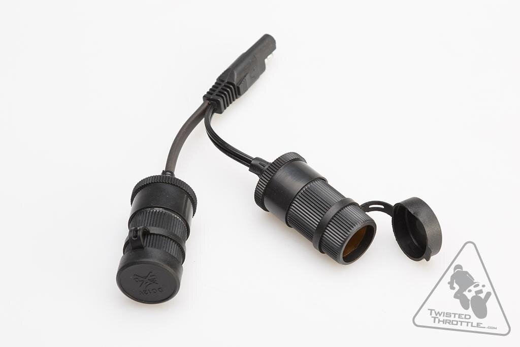

The link takes us to an empty shopping cart. Is this the animal you have to connect to power?
I have one to connect as you are doing. I also have one with 2 female ends, just in case more power is needed.
