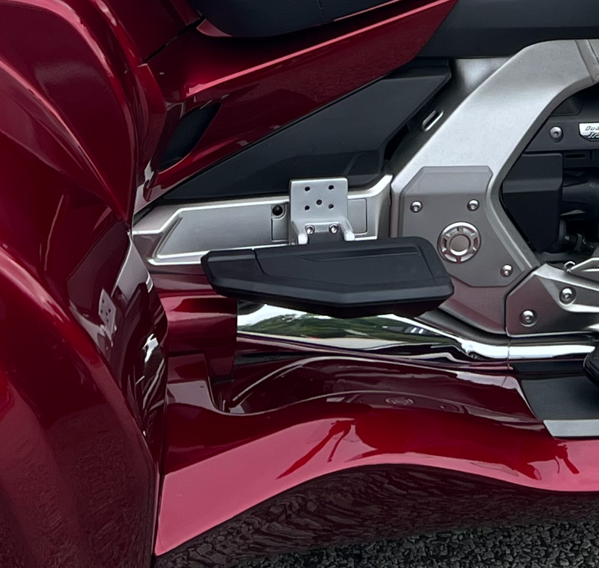

I have a 2021 CSC conversion. The Omni floorboards will only work if you use risers as well. The Omni floorboards by themselves will hit the fiberglass body near the exhaust. You need to also use the Show Chrome risers and raise them up. I use the lowest raised location and it clears the fiberglass body. Here is a link to the risers.... Show Chrome 52-961E Goldwing Passenger Floorboard Riser Set
You can seen the risers in my pic below. You can also see where the rear portion of the floorboard would hit the fiberglass body near the exhaust without the riser.
