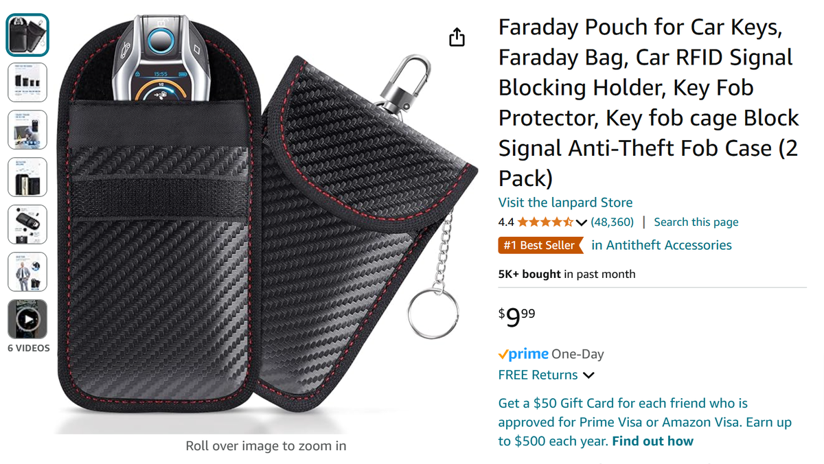

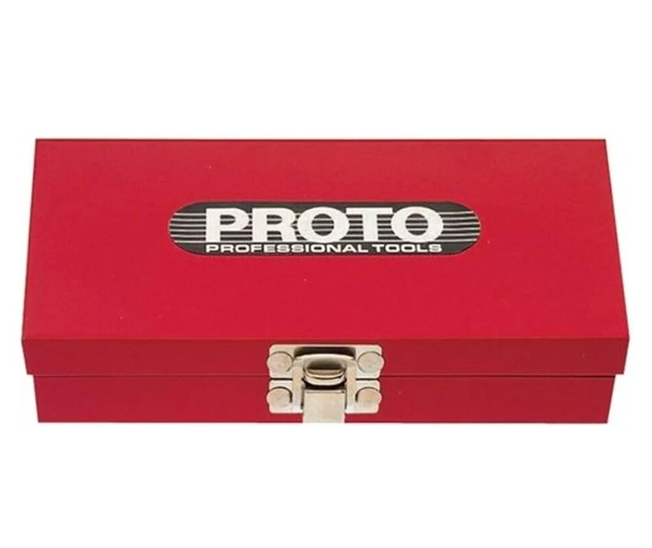

We have done a lot of new Goldwing DCT conversions since they came out back in 2018 and have learned that if we don't store the key fobs inside a metal box, inside our file cabinet, in our front office, the fobs will each constantly "talk to" their bike, which will run the battery down. We use this box I bought off of Amazon to serve as a Faraday box. Make sure your key fob is not within close range of your bike as it's signal can communicate with the bike. For example, hanging the key fob on a key hook, just inside the garage entry door. There are lots of inexpensive Faraday boxes and bags available on Amazon.
