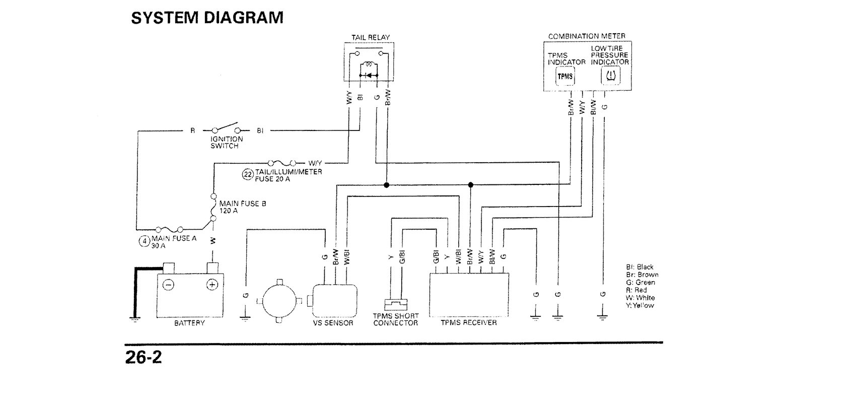

The 2009 -2014 GL‐1800 is equipped with a Tire Pressure Monitor System.
To bypass this system '09-'10, you will need to take out the right front fairing pocket, on 2012 > remove headlight adjust panel.
Next, located the gray plug and take off the yellow holder.
Next, jumper the white wire with the yellow tracer to the solid green wire.
This will eliminate the rear wheel signal. The front wheel will still be active.
The light (TPMS) will come on and then go out when the bike goes above 25 MPH.
Can anyone confirm ?
I want my TPMS light to go out, and still have it monitor the front tire.

I would look under the right hand pocket and see if you can find any place they jumpered/spliced. Maybe the connection came loose.
By the way, the instructions that I posted, that came from MT, don't appear to work... either that or my front tire hasn't lost the 2~3 pounds of air that it usually does.

I just talked to the Service Advisor at the Honda shop, when they install the trike kit on a bike with TPMS they jumper two wires going to the TPMS receiver to disable the rear tire but leave the front activated. They said they have had some problems with the crimp connectors on the jumper and it will be an easy fix. As long as the front tire sender still works and I can monitor it I will leave it hooked up, once the front tire sender craps out I'm going to have it shut off.
Took my trike to the Honda shop today to get the TPMS problem fixed, when they jumpered the two wires to disable the rear tire the crimp connectors they have been using have been causing problems, they re crimped it and so far it is working properly and I still have monitoring of the front tire.ThumbUp
