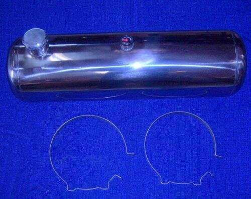

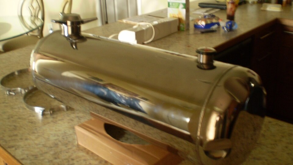

Ordered a new stainless tank & some new gauges :-)

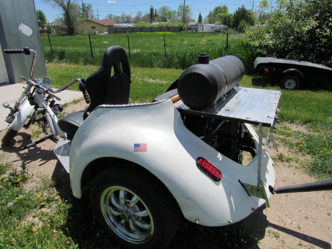

As Fowler states, you will run into a storage issue. I had pretty much the exact same issue with storage when I went to put a 11 gallon tank on mine.
As you can see from the picture below, I solved that issue by cutting part of the body and building a small flat bed for the tank as well as storage behind.
After putting the bed on, I purchased a storage trunk that was made for a rack on a ATV four wheeler.
I grabbed this one:
https://www.amazon.com/gp/product/B004IUMZ92/ref=oh_aui_detailpage_o07_s00?ie=UTF8&psc=1
It worked out perfect for my application. The bed that I built is 32" wide by 24" deep.
My longer plans are to build some upright "stakes" that come up about 10 to 12 inches and be able to drape some chrome or silver chain between the uprights. Then if I prefer to remove the storage trunk I can install the stakes and it wouldn't look so bare.
Maybe you could fab something similar and have it work great for the fuel tank and a storage area.

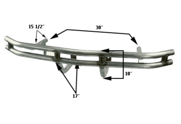

The stainless tank came in today. I am adding a new duel tube bumper to the rear of the trike for safety. The tank will be secured on a heavy gauge stainless steal plate. The mounting plate will be secured to the original engine guard and the new rear bumper. More pictures to come as soon as the new bumper gets here early next week.
