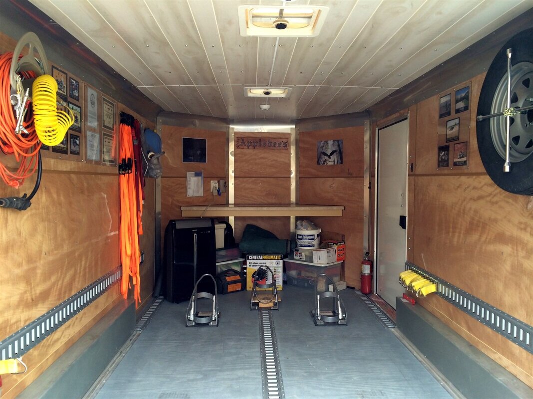

Nice to have that much room but for most of us not practical. I bought my 2010 8 X 12 V Nose Wells Cargo Express Wagon back when I had two full size two wheelers to haul on trips. I have since retro fitted a third wheel stop for the trike. All that stuff up front stays right there (well most of it anyway). Trike/bike position compensates for load position. :xszpv: :xszpv:
