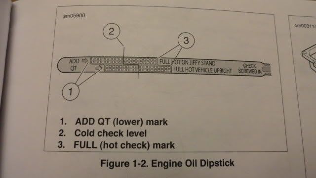

:AGGHH:I have a 2007 Ultra with Roadsmith conversion and I am not sure how to check the oil levels. If I change the oil then I will know, but I have good Synthetic oil in all 3 holes and don’t want to lose the oil. Can someone help me out.
Thanks-

Look on the backside of your dipstick. There should be a couple of diamonds that are about the same distance apart as the normal side. The diamonds will be just about 1/4 " or so higher. Those marks were there for reading if a sidecar was installed. makes it the same as a trike. If you don't have those diamonds let me know and I will give you a different way.
I had the same concerns until I looked in the service manual. I have a 09 Ultra/CSC. The Service Manual shows a picture of the Engine Oil dip stick and there are 2 different marks. One says FULL HOT ON JIFFY STAND and the other says FULL HOT VEHICLE UPRIGHT.
