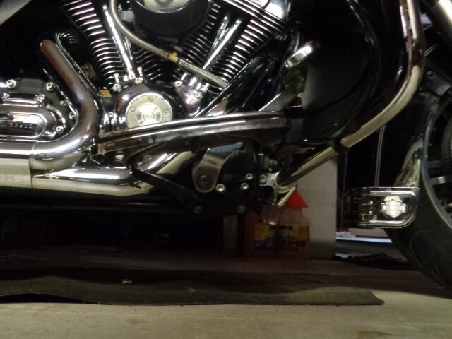

hile shining on old shiney noticed a drip on floor!!! :AGGHH: After full investigation oil was transmission oil coming from clutch cable housing just away from tranny. :gah: My question is.. opinions please need clutch cable replaced or possibly save the one year old Barnett cross bones one I have? all comments welcome. :Shrug: fearless

Have you had it in for service recently? If so, chevk the bolts on the transmission cover. Those knuckle dragging Harley Technicians have a tendency to loosen them and not re-tighten them to specs when they change the fluids. Has happened to me about 5 times since I've owned a TG and a XXX. I now go behind them and check the oil pan and transmission cover every time I get the fluids changed.
The first time I noticed it, the fluid was leaking onto the bracket that holds the pipes on (right underneath the cover) and it smelt terrible when heated up.

Shiney being 09 vintage I do my own work I changed handle bars a year ago and had to mess with clutch cable location I have probably caused my own grief doing so. :Shrug: just sayin. I do the service just to have the experience and knowledge to do it.
There is a rubber o ring where the clutch cable enters the housing. Sometimes the o ring degrades and causes a leak like you describe. I believe you can just replace to o ring and save the cable.
That is what I hope
I hope so but it seems dry coming out of the tranny it gets wet below the compression collar we can only take it apart and see. As we all know taking it apart means starting at the back muffler supports and working forward to the header flanges. :AGGHH: Gotta love it. :Shrug: fearless

It on the vinyl side of the Compression furrell, I fear it was self inflicted at time of install. Being my first time handling a clutch cable I probably not as careful as I should have been. +3" which is the length of Cross Bones cable there is no extra cable to play with for positioning in frame had me :gah:"nuts". I will be replacing it soon with I hope a +6 and pray it is not to long. A independent dealer said the fairing should really help me out. :Shrug: Any input would be greatly appreciated the leak is my own doing live, laugh and learn. :AGGHH:ride safely fearless
