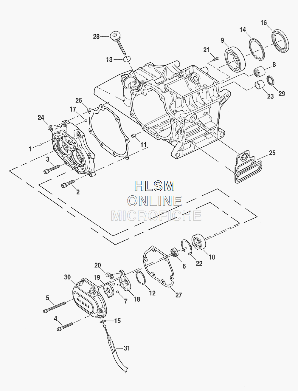

I had a leak between the ferrule that screws into the tranny and the flexible part of the cable. (2010)
My 2011 at around 30,000 miles start to get wet around the ferrule but it never really leaked..
Your not the only one
Clutch cable second seeps more like barely but it does collect dust sort of... not dry for sure. run it and watch it. Fred
# 15 is the clutch cable seal on the tranny trap door cover, it will leak oil. I doubt the oil could leak up as far as the cable adjuster. Wipe it down good, run it and recheck the leak
