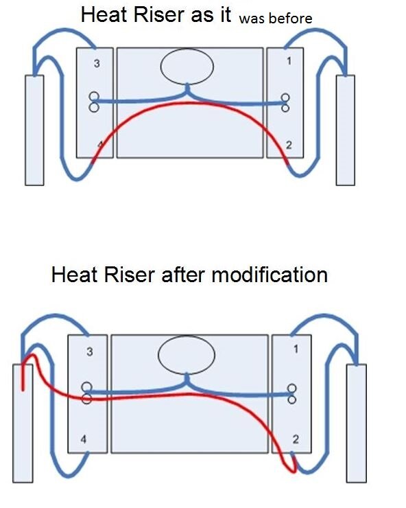

With a Center mount carb you have to worry about icing. That is why I have the fully heated intake. The heat risers go all the way though the intake to heat it up.
Also with heat risers it maters what type of exhaust you have or you have to do some modifications

Icing is just an issue with a center mount carb. from what I understand with dual mounted carbs the heat from the heads radiate up the individual manifolds so its not an issue.
With a single mounted carb you could keep your heat risers the same a lot of people do but to make them work correctly on some aftermarket exhaust you have to modify them. Again a lot of people do not do this and do not see any issue
This is how I modified mine. it seems to work good
If a extra diagram shows up here its because I cant seem to remove it
