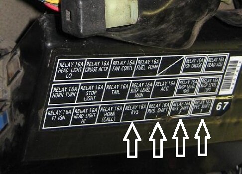

Check these relays in the box under the seat. See white arrows.
Swap them with ones of the same rating.

Of the 4 rev relays, the 2 to the right as looking at them have 5 legs each. The 2 to the left have 4 legs each the the furthest has no noticeable power to it with key on it off. The next one has power to all legs key on or off.
Also, the 100amp fuse and 70 amp fuse in fuse panel left of battery, the 100 amp power key on or off, the 70 amp no power key on or off. The solinoids to right of battery first one power key on or off. Can't get to second very good but test light is fun on first post.

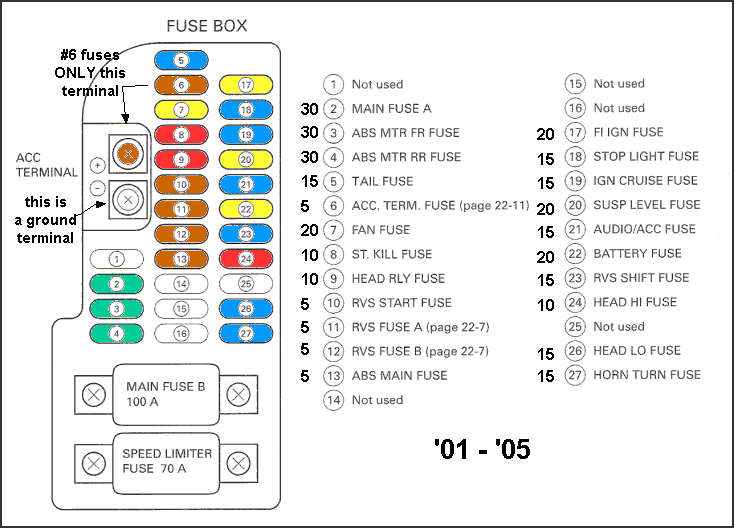

Have you checked the reverse fuses to see if any of them went bad?
Below are two different years fuse boxes.
One is 06-08 and the other is 2001-2005.
Check the reverse shift fuse also.

These are the two pics of the fuse box cover.
Thanks trike lady I'll look at them tomorrow. Picture is worth a million words. What I did check in there seemed fine but mite get an assortment of dudes and replace the iffy ones. The 100 amp showed power, should the 70 amp show power as well?
The 70amp speed limiter fuse protects the speed limiter relay for reverse.
If the system got overloaded at some point in time it may have blown.
It should have power.
With the reverse button pushed in the light on the dash should switch from 'N' to 'R'.

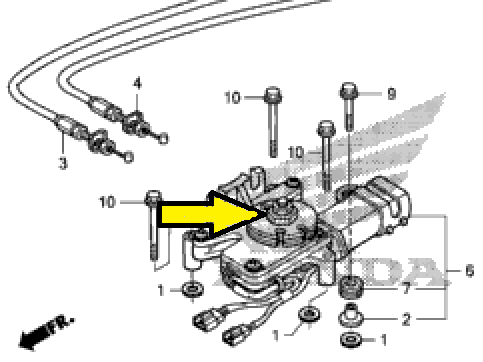

The pics of the reverse actuator.
The yellow arrow points to the nut you'd want to turn to release the system, take all reverse fuses out before trying to power up and start the bike. You want to turn the bottom one, not the top one.
Red circle shows close up of nut.
