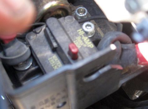

Got all the fluids changes, new oil filter, new air filter, new spark plugs and now onto the reverse.
No response from the controls pulled the right side cover and looks like the breaker has tripped?
Push the red button to test then the lever that opens after the button is pressed push it back in and it should work..Cant tell it the lever is open in the pics..
Just wondering if you see the lite come on when you press the reverse button? then the arrow?
Welcome to my world....breaker tripped on my '13 TG last weekend on a trip. Push in the red button and right under is a "flag type" black square plastic lever that you have to PUSH IN also. And, there is nothing wrong with Syn 3 oil....been using it for years!

Keep in mind breaker has been known to 1/2 trip. Once my breaker and entire reverse motor were replaced (with stronger one) it hasn't tripped again. There have been a couple of cases when backing up a hill, gear got stuck on drive. Had to be careful when leaving. Needed to rock trike to release reverse gear. You can hear it whining when it does that.
