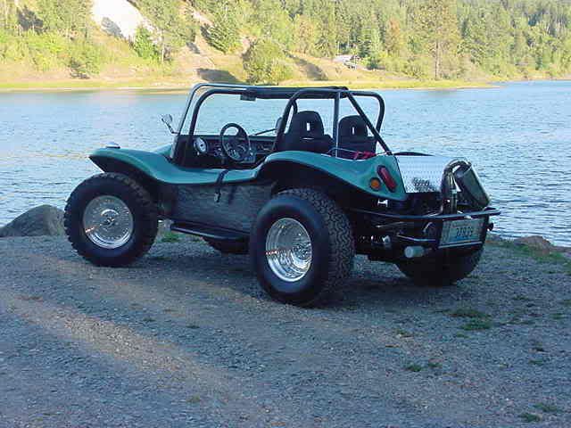

I have built from ground up around 15 Hot Rods, 5 dune buggies, restored two Harley FLH's etc.... You get the idea, so I can wrench myself and have all the tools on hand except for any specialty ones that could be needed.

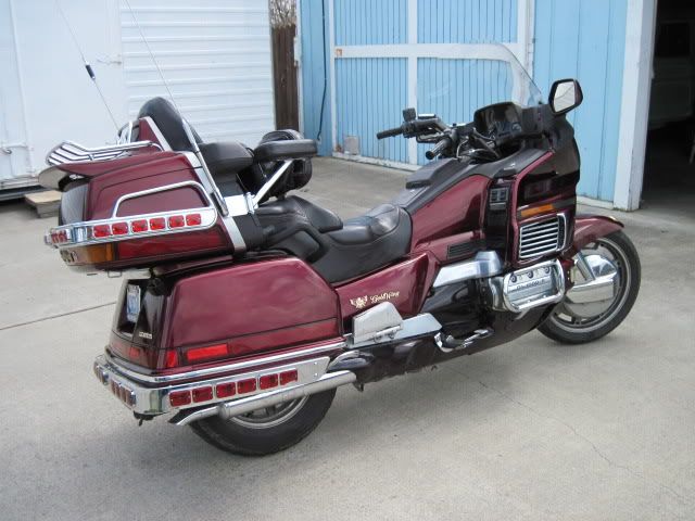

Our Wing now......
If we cannot afford to go to a trike, this is what we will return to. But there is a difference in "driving" something and "riding" something. Even though they are both open vehicles, there is a difference....:Shrug:
