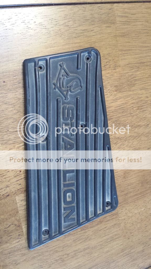

Another question. The rubber step cover is missing on the passenger side. The gentleman that I bought it from said it "blew off". The drivers side has 6 screws holding it down. Did it originally come screwed down or just glued on? The screw holes look random. Here's a pic of the drivers side after I removed it (using it to make a template).
I sent Brandy at motortrike an email about these at the same time I posted this. She has responded that my trike is one of the plastic (not fiberglass) bodies. Yes, the screws were added by a previous owner. They do have the step covers in stock for "only" $131.25 each plus shipping. I'm thinking about making a matching set out of this. $6 at Harbor Freight for a 12" X 12" which should make two.

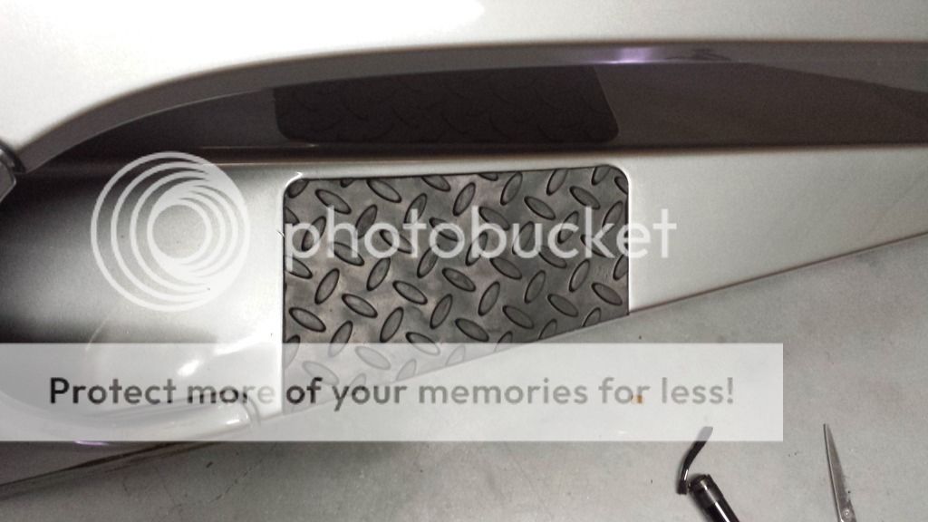

22,000 miles on the trike. Other side heim joints do look OK and they were not adjusted as far out. I'll double check it again. I'll lower the shock setting to the middle and try it out. I put 2 new rear tires on today as they were the originals as per date code. Starting to dry rot / sidewall cracking. I'm going to replace the front also next week before riding. Here's the new side step rubber I made. What do you think? Thanks for everyone's input. I appreciate it.

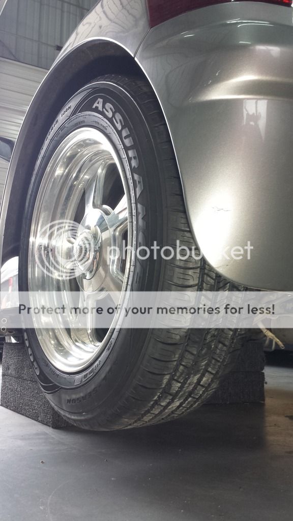

Got the new front tire on and upgraded to all 4 chromoly heim joints. Had a problem with the valve stem. It broke when we went to replace the rubber seals. An 8.3MM was the smallest size I could find listed anywhere. It was still larger than the original and had to drill out the wheel. Found a 90 degree one. BTW, I'm pretty sure TMS had the wheels made by Budnik Wheels. They look just like some I had on a 32 Ford back in the early 2000's.
