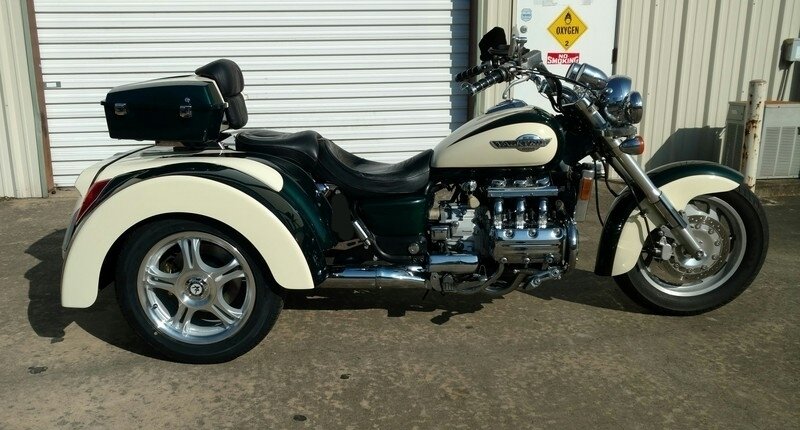

Well, I brought my new trike home yesterday. I took my 97 Valk to Mr. Bazooka a while back and he installed a new Roadsmith trike for me. It really turned out nice and I couldn't be happier. It is going to take me a while to get used to it but I am patient for an old guy.

Enjoy the new ride - POST PICS! :)
Nice to see a happy owner and from what I've seen everything Randy does he does a great job. Congrats on the new trike and enjoy many miles of riding.
Beautiful ride. In my Valk trike I ran 40 psi front & 24 psi rear.

Congrats on that beautiful ride.

WOW!!! Nice looking ride Elliott! That two-tone paint job really sets it off! Enjoy!!! ThumbUp
Nice job Bazooka!!! ThumbUp
