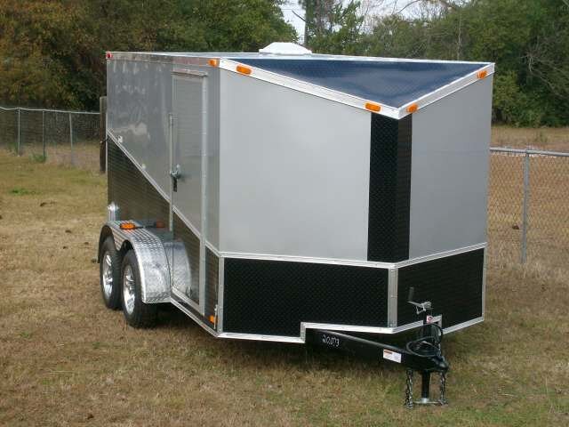

Well I finally pulled the trigger and ordered a trailer to haul Elvira.
2016 Diamond Cargo 7x12 tandem axle.
16" O.C. floor cross members and side members
4" tube frame
225-75-15 D rated radials
60" extended tongue (for towing behind the motor home)
All LED lighting
BTW, this pic is of a in stock trailer and does not include some of my options
That is a great deal - Near you? jc
Not at all, I am in Texas and the Texas trailer manufacturers would not get within $1800.00 of this price built to the specs I want. They want to do cookie cutter trailers, not built to spec
It is being built in So. Georgia. About 850 miles from me.
My Lady and I will make a road trip out of it and spend the weekend in New Orleans.
