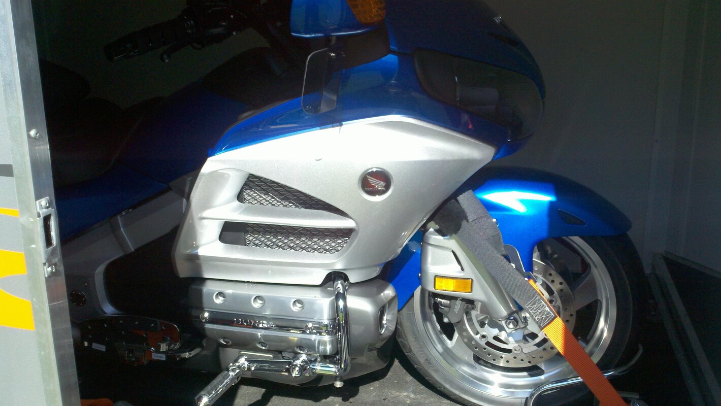

Hey Fellows, I need your unbiased opinion here on if I can improve on securing my Goldwing trike in my
new 7 'x 10' trailer I picked up today with electric brakes.
I'll be pulling my Goldwing to Florida this winter and have 34 years of pulling boats, but never a trike fasten in a enclosed trailer.
Here's a few pictures I took before it got to dark to work on it.
What do you think?
Cheers!

Looks to me like that dog should hunt just fine Mike. If the wheel lock is bolted through the floor instead of just screwed into it, you might wrap a soft tie of some sort through the front wheel and around it. Not necessary but would add a little security.:xszpv::xszpv:
HAPPY HAULIN'. :D
You may want to consider putting chocks in front and behind rear tires. May be an overkill but would be good insurance that it doesn't rock forward and backwards when you start and stop.

Thanks any suggestion will be greatly appreciated.
Yeah I just might do something will the front wheel chock for security.

I'd be real careful pulling on the front engine guards, they bolt to part of the engine mounting. I managed to snap an ear off the right side just by pushing myself up in the seat on the highway peg. If you break the mount, it won't be a cheap fix. I go up around the bottom triple tree, one strap on each side.

It is where the forks mount, you have a top and a bottom. Ask any knowledgeable dealer and they'll tell you not to use the engine guards, yes there are folks who used them without issue, but the laws of average say sooner or later something is going to break. It is so simple to throw the strap over the bottom of the tree and then pull it into the chock with the straps. I pull it into the chock and compress the front suspension some, this way the suspension isn't cycling up and down with the bumps all the while it is being towed.
Yes don't hook anything to the engine guards.... They break off in a heart beat... You might also get some heavier width straps, like this fellow has pictured around his triple tree.... They are much sturdier under load...

Ok fellows, I change my hook-up process, but still using the orange 1" straps.
This time I took the side covers off and attached the straps (soft ties) in a "front" pulling force,
and the back straps are in a "back" pulling force attached to the Roadsmith towing lope near the axle.
What do you think???
Front pulling forward with soft straps attached to the corner mounted tie-downs
Here's the back end pulling back from the corner mounted tie-downs.
Here's a Goldwing trike that I feel comfortable towing down the highway.
I might go to heavier 2" straps..............:Shrug:
That looks like it should ride better, biggest thing is you're not pulling on the engine guards. Sure there are folks who use the engine guards, they've been lucky and not found a broken mount and a large repair bill.
