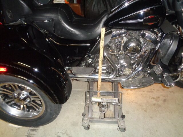

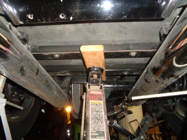

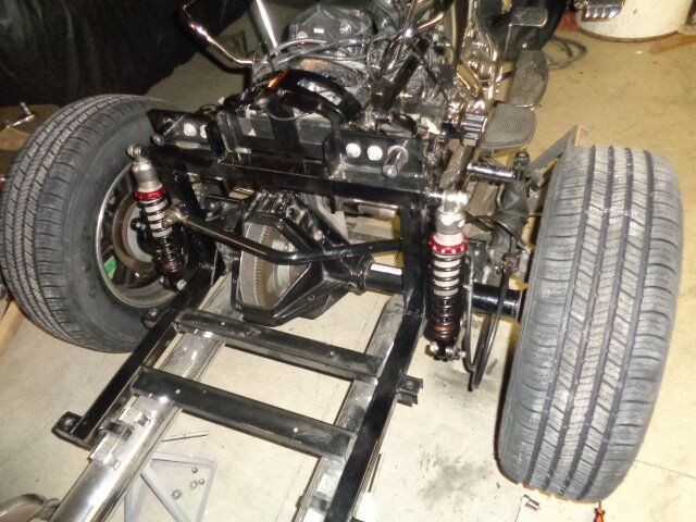

It can be done with the body on it is time consuming I prefer to take off the body. With a bike jack under the front and small trolley jack under the back it should not be that hard. Once jacked up place stands on the rails under the trunk, that will give you more room to work. I would take off the wheels and follow the instructions. Good luck it should go well, either way. Ride safe FredDSC01531.JPGDSC01527.JPGDSC01563.JPG

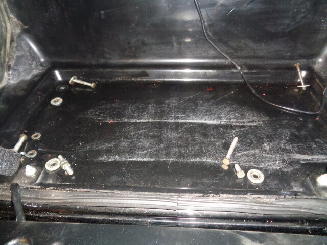

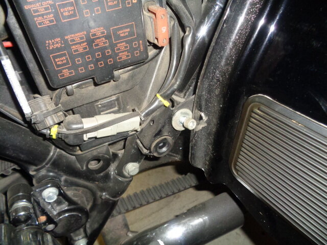

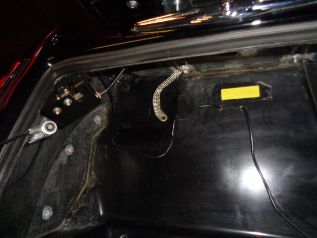

So i see 4 mounting tabs for the body at the rear are there two under the seat?

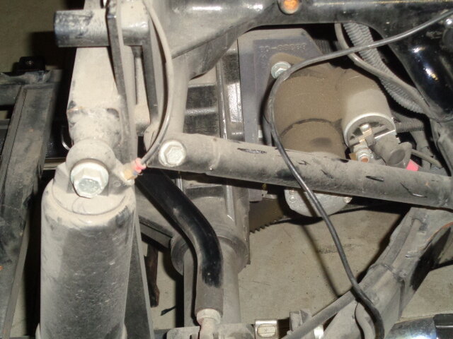

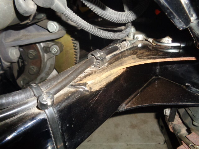

There are two in the trunk up high on the front wall. The one on the left is a ground strap and a stud bolt that needs to come out and the right side is cap screw bolt also. On each side there a is a Alan head bolt mine are silver colored on tabs above the foot rest they also need to come out. I did not find the body and tourpak overly heavy to remove in one piece. Be sure you unplug all wires and disconnect antennas. Which means emptying tourpak and removing liner. When going back together be sure to properly torque the bolts on body as per specs. Prevent loose grounding and squeaking. Good luck. Any issues PM me and I will do what I can to help wrench safely FredDSC01534.JPGDSC01537.JPGDSC01535.JPG

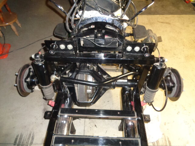

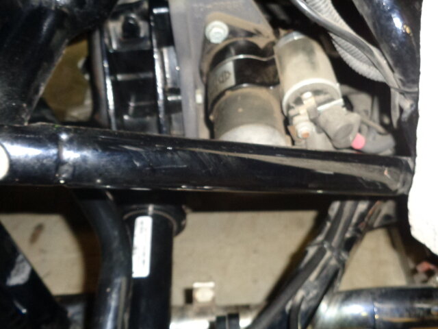

When you do don't be surprised at the amount of road grime under there. I would look at everything Panhard rod ends if they are rusty looking and loose swap them out, if they are tight lube them. Also check brake lining, Drive belt alignment and a good general cleaning of course Shiney was old when I did it he first time. Give the back side of the wheels a good cleaning a splash with clearcoat. I found a few spots where the powdercoating failed and I needed to address them as well. Ride safe Fred
P.S. As you can see these photos are pre Pro Action upgrade mileage was around 26,500

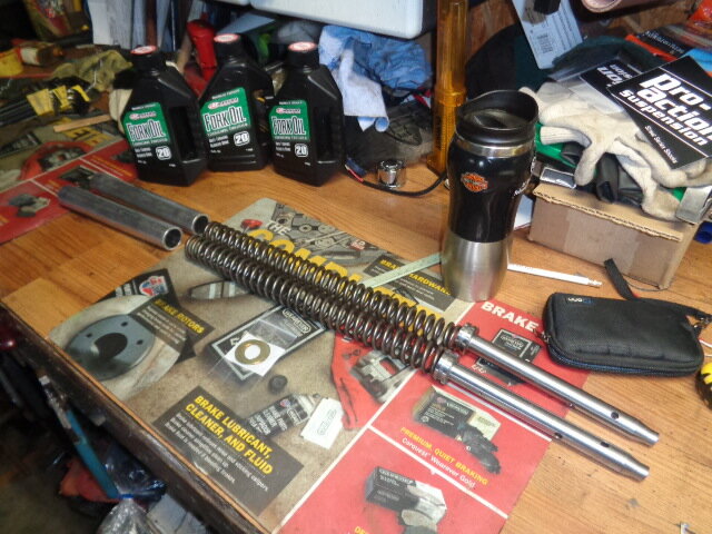

ride for sure. If you really want an eye opener upgrade the front forks with Pro Action fork kit Georges springs and new valves he has developed make a sports trike out of a wishy washy ride. :good:travel safe Fred
