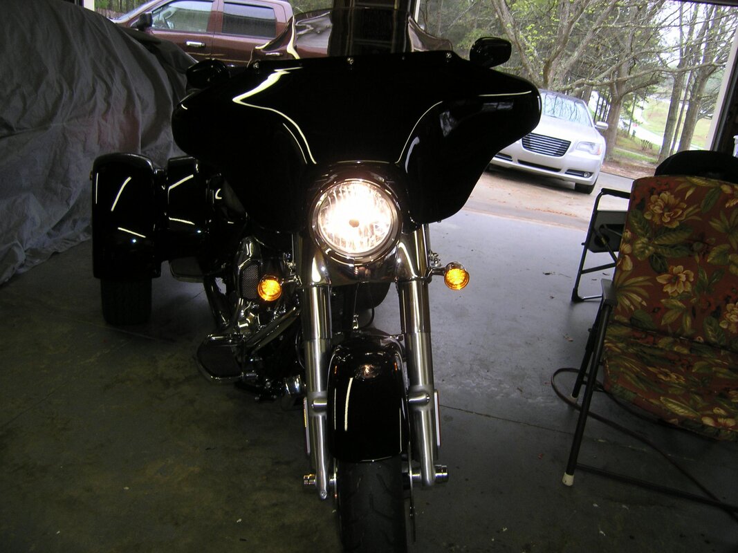

Replace back tail lights with new Harley LEDS and front run and turn signals. I have a Truck lite front LED on order.

Just a heads up on those rear LEDs, you may want to use some silicone around the back of them where the wiring comes through.... the MOCO screwed the pooch on the design of these. There is a huge whole in the fender right where the wiring comes through, if you ride through any rain or water it will fill up the lights. I am on my third set, the last set had close to 2 cups of water on the left side and about a cup on the right.
