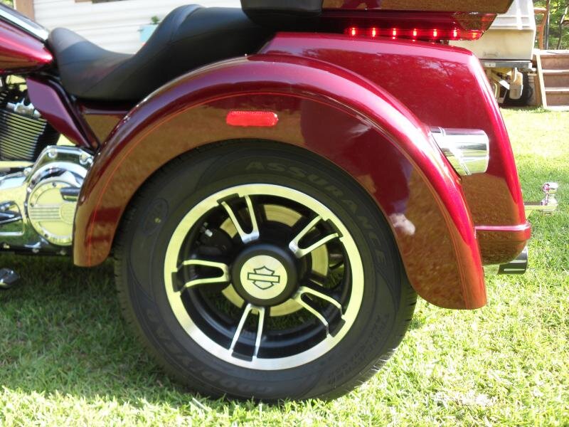

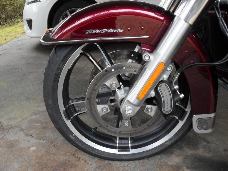

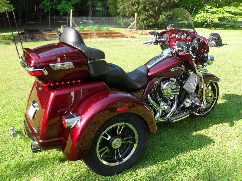

I am considering putting Harley Enforcer wheels on my 2015 tri glide but have some questions.
It looks like Harley sells the 15 inch wheel for the rear but the front one is a 19" wheel vs. the 16" wheel that is one the front of my bike now. If I put the 19" on the front how is the bike effected? Does it change handling? Simply put is this a good thing to do.
I put a 21 on the front of mine. It raised the front about an inch. No noticeable affect on the steering. I like it a lot.
Is there a way to calculate how much higher the front of the bike will be with a 19 inch wheel vs. the 16 inch wheel assuming tire side walls are the same?
A Dunlop 130/90/16 front tire is 25.17" diameter and a 130/60/19 is 25.27" diameter.
