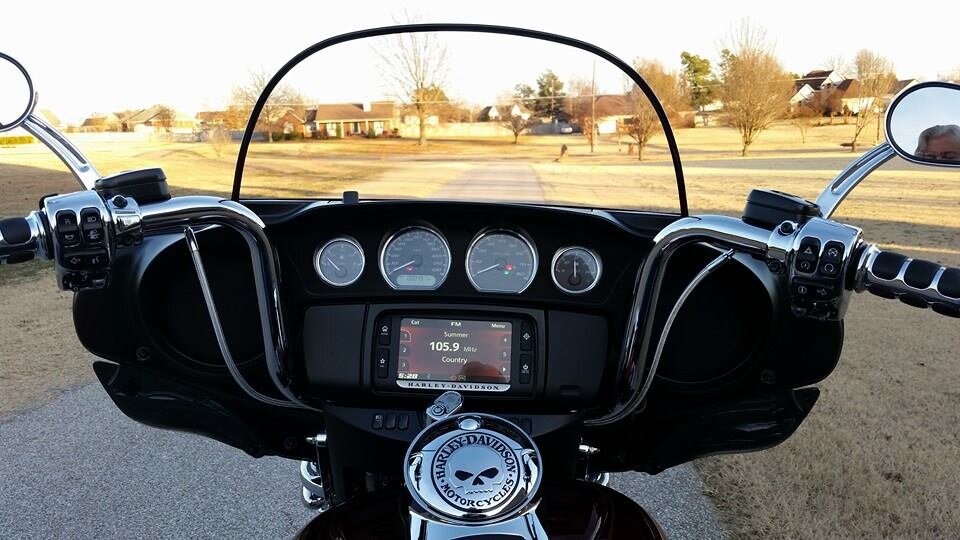

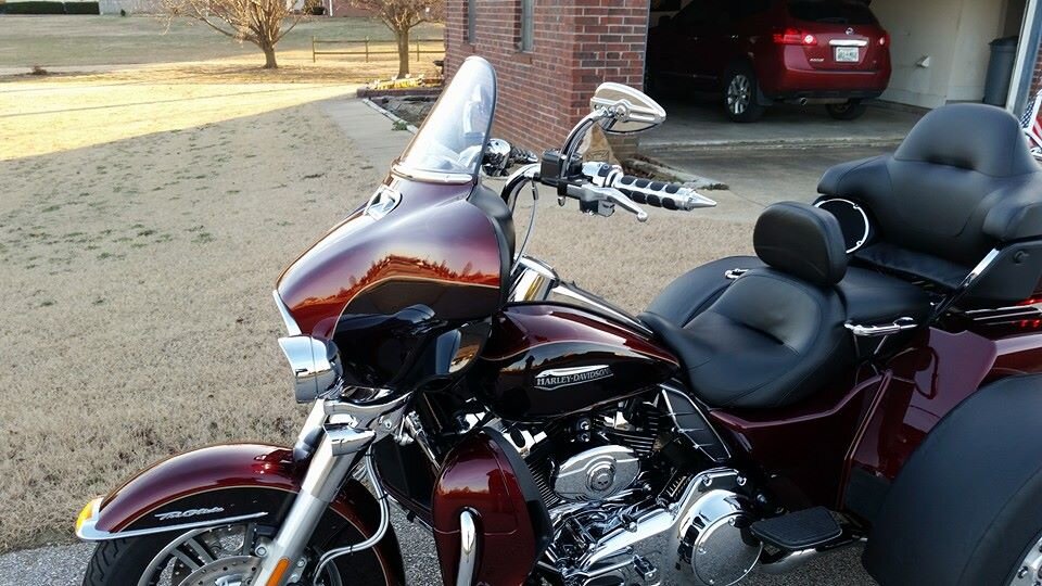

Finally got my new handlebars on. They are the Wild Ones 12.5" bagger bars. WOW! WHAT A DIFFERENCE! I'm 6'2" and the stock bars just didn't work for me at all. I now truly feel at HOME on the TriGlide. I also had "Heat Demon" heated grips installed at the same time. It also handles like it has power steering

Very nice. I'm not as tall as you and want to go with the LA Choppers 10" twin peaks handlebars
did you have to extend all the wires and cables or just the clutch cable?
No milling of the bars, just had to drill a small hole for the heated grip switch wires. Didn't have to change grips either.
My hands do get more wind which in one of the reasons I also added the heated grips. For me the difference it the way it now feels and handles far out weighs the extra air on my hands.
Are those bars bigger than 1inch dia?? The reason I ask is that I bought a set of the heat demons and they would not fit ----- then in the fine print at the bottom of the instructions it was indicated that milling of the inside of standard 1inch bars was req'd for them to fit.<br />
Sent the Demons back and bought heated gloves.<br />
I would still like to install a set but really do not want to go through the pain of pulling the bars off and carting them to a machine shop.
Wonder if your bars may be constructed with a thinner wall material to allow them to be reformed from 1 1/4" down to 1" as opposed to a standard 1" HD bar?? That would be my best guess.
Not sure about thinner wall construction, they look about the same on the ends as my stock bars do. My friend that has a 2013 TriGlide is who told me about the Heat Demon grips, he has them on his trike with stock bars.
