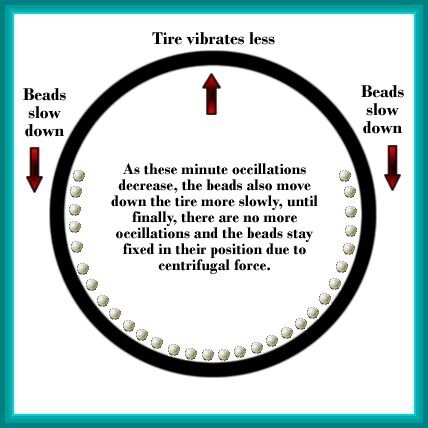

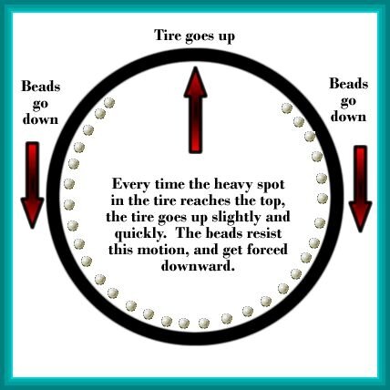

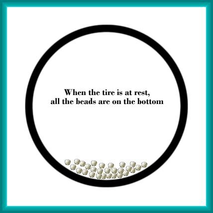

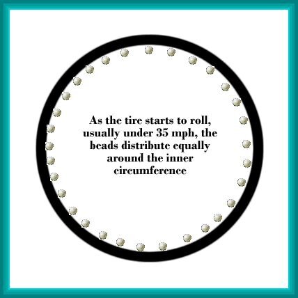

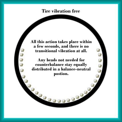

Have used that product in my tires for years as it not only balances, it provides puncture protection.
I see that the kit comes with two packages of beads , do you put one or both of them in the tire? thanks for that reply, also it was quite informational.
Put them in per the instructions. Let us know if the take care of the problem and how you like them.
We have quite a few different combo packages that you can see HERE.
This is what should be run in the tires-
80 - 120 mm tire width 1 oz
130 - 230 mm tire width 2 oz
240 - 360 mm tire width 3 oz
Rear Tri-Glide Tires 4 oz
