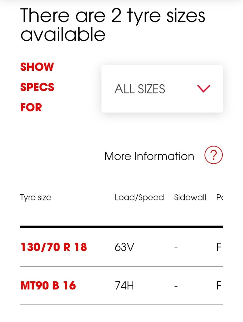

My question is can (or should I) run the skinny 18” Avon trike tire on front or do I need to be swapping the rim/tire out for the fat 16” Avon trike tire?
That's a personal preference, I would stick with the 18" wheel and tire, but if you like the look and don't mind dropping a grand for the cool factor then go for it. The stock 18" tire has proven to provide good performance for years now, so I don't think there is any need to switch to the wider 16" wheel and tire based on grip.

One thing to point out. The Avon 16" trike tire is a bias ply and a higher load rating than their 18" radial trike tire that is designed for the Goldwings
