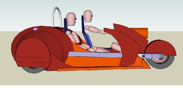

New build with a difference, the Strike.

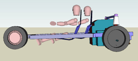

A rainy Sunday so i stayed in and played with designs as I haven't yet commited to the forward frame.
William Shatner's Rivit gave me some ideas to play with, albeit on a much smaller and more modest design scale.
This is actually very easy for me to build due to my experience with aircraft construction.
Maybe I should run a poll to see if the sidecar cross above, or this tandem is what I should build?

Thanks for your replies Lee and stacebg, sorry for my delay.
The stability isn't an issue, a reasonably tight center of mass located not far in front of the rear wheels, and a low center of gravity will offer stability - it's all about leverage.

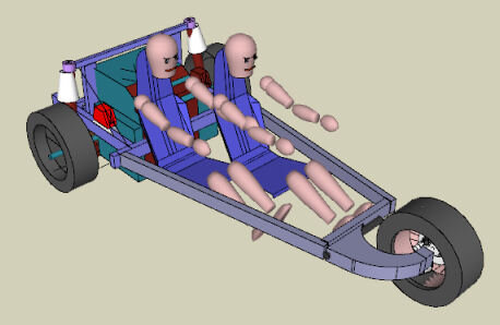

But as things go, computer 3Ds are one thing, building the real thing is another, and a tandem trike is easier to build with resources to hand. I have started the frame and getting that side of it sorted, some frame pictures in a few days.

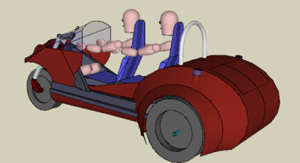

I have been playing with the exterior design as well, of course it's just simple 3D stuff. I'll just grab some screenshots ...

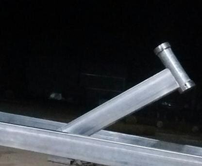

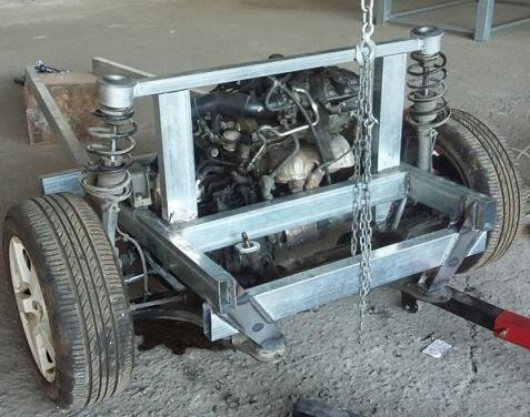

Today I lasered up the rear crossmember mounts and welded them in with a new chassis member. Then set it up with wheels on and on suspension (rachet straps binding the strut cross bar down) to check ground clearances so I can design further.

:goodjob: Mark, it looks like design and construction are progressing very well.ThumbUp

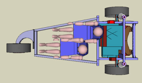

Having wheel problems in that I can't get what I want up front (it's complicated), and one piece of the puzzle seems to be missing in each direction I take to get to a paricular result that I wanted.
If I go back to the original Strike (Trike/Sidecar), then the offset naturally allows me to use a center hub control arm/steering that offers me a number of advantages, low profile, lower center of gravity, better aerodynamics, etc.
I have spent the last few days designing on the computer, and hitting the local parts shops resourcing cheap OEM common parts (a Toyota HiLux lower ball joint for example), and haven't hit a brick wall yet.
Not only that, but it allows me to use the rear wheel disc brake, hub and stub axle for the front wheel from the same VW Mk 4 that the engine, driveline and suspension came from, and all 3 wheels are the same size and tire. Bit weird that all the VW front stuff is up the back, and the rear stuff is up the front now!

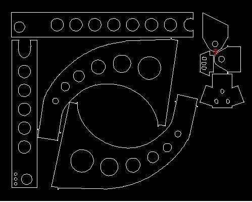

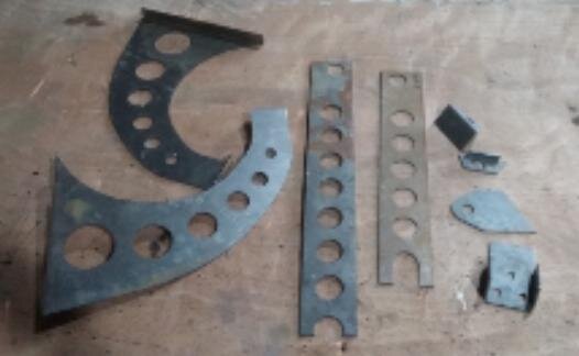

Did some hours today designing, will laser out the parts tomorrow and see how it looks.

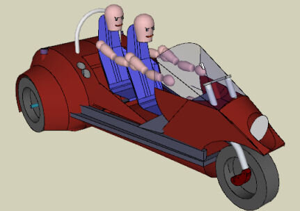

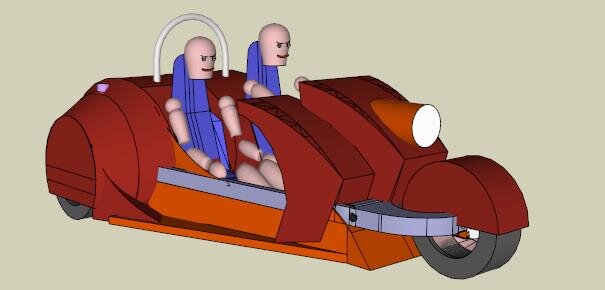

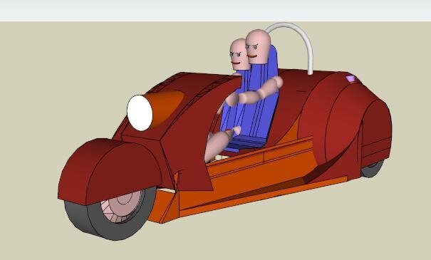

The new found low profile with the center hub steering at the front will allow me to build a sleek body profile over it, a bit like a Stallion but squashed I guess. ....
Is it a Trike,? is it a Sidecar? is it a Sportscar? Is it a Tourer? ... why yes, yes it is.

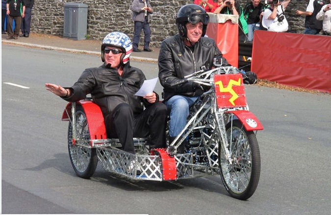

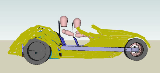

This Sidecar, made from Meccano sets, actually has a similar seating arrangement to my original concept.

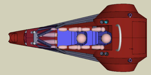

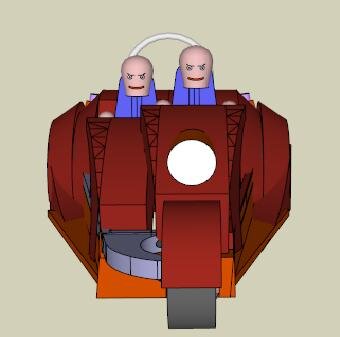

Still playing with styling, going to have to make a decision soon though ....
I would mention again that my computer styling skills are minimal, a little imaginination required!
