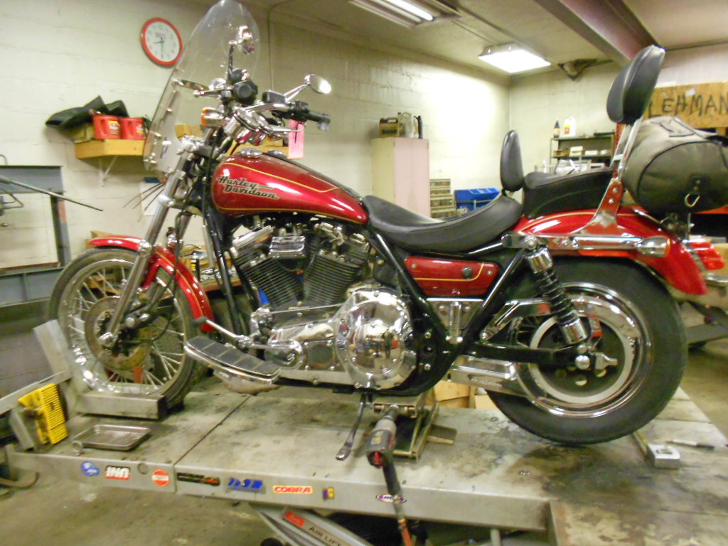

EVEN THOUGH THE MOTORCYCLE WAS SQUARE WITH THE EXISTING PARTS, IT WOULD NEED TO BE SQUARED SO THAT THE NEW SWINGARM AND AXLE WAS LEVEL TO THE MOTORCYCLE AND THE ENGINE WAS IN THE MOTORCYCLE SQUARELY FOR THE NEW PARTS. HARLEY-DAVIDSONS ARE NOTORIOUS FOR MIS-ALIGNED ENGINES.

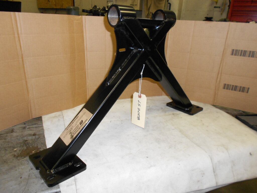

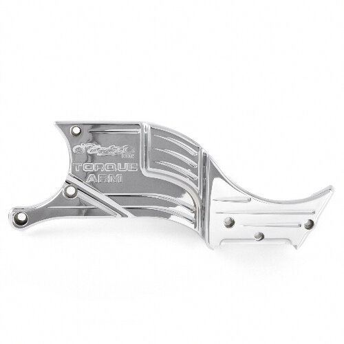

HARLEY-DAVIDSON PRIOR TO 1999 HAD INNER PRIMARY CHAIN HOUSINGS THAT WERE NOT VERY SUPPORTIVE WHEN IT CAME TO A TRIKE CONVERSION. IN EXTREME CASES THE INNER PRIMARY WOULD CRACK OR THE TRANSMISSION HOUSING WHERE THE SWINGARM PIVOT PIN IS LOCATED WOULD BREAK OFF. STIFFENING THE SWINGARM AND REAR ENGINE MOUNT BUSHINGS WOULD HELP.
BUT A CARLINI TORQUE ARM WOULD HELP STABILIZE THE OTHER SIDE AS WELL.

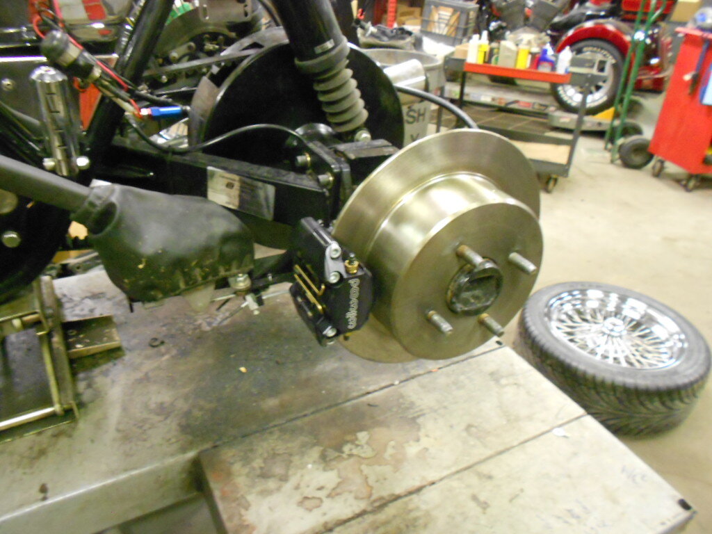

NEXT WAS AN UPGRADE FROM DRUM BRAKES TO DISC BRAKES. I HAVE BEEN DOING DRUM TO DISC CONVERSIONS FOR A OVER YEAR OR MORE SO I HAVE SCROUNGED UP ENOUGH PARTS TO PULL THIS OFF. IT EVEN HAS AN OPERABLE PARKING BRAKE. I DID FIND LATER ON THAT THE RIGHT CALIPER HAD A BAD O-RING AND WAS LEAKING SO I REPAIRED THAT PROBLEM.

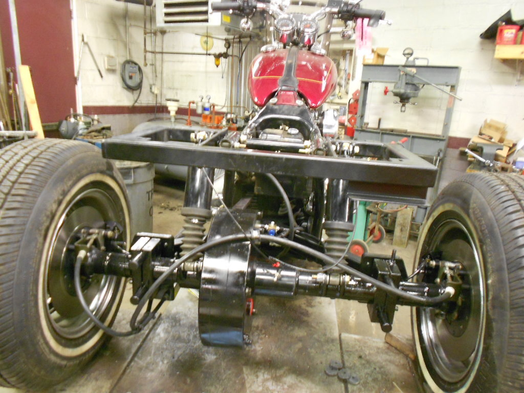

THE KIT DIDN’T HAVE A BODY FRAME BUT I HAD ONE THAT HAS BEEN AROUND THE SHOP FOR OVER 15 YEARS THAT COULD BE MODIFIED TO WORK. AFTER MAKING THE MODIFICATION AND ADJUSTMENTS I INSTALLED THE SHOCKS. THE STOCK SHOCKS WERE TOO LONG SO I HAD A PAIR OF AIR-SHOCKS FOR AN ELECTRAGLIDE THAT WOULD WORK IF THEY WERE GOOD.

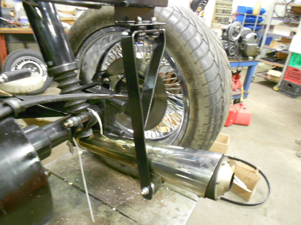

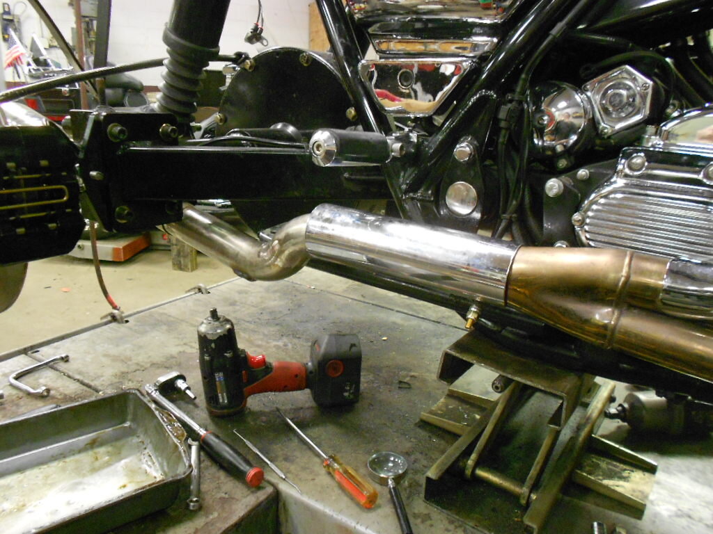

IT HAS A SUPERTRAPPE 2:1 STAINLESS ADJUSTABLE EXHAUST SYSTEM AND WOULD NEED TO BE LENGTHENED ABOUT 18". I NEED AN “S” PIPE SO THAT THE PIPE WILL CLEAR THE REAR HOUSING AND UP-SWEEP FOR THE MUFFLER. I WILL ALSO NEED TO FABRICATE A REAR MUFFLER HANGER THAT WILL HAVE ADEQUATE MOVEMENT TO PREVENT VIBRATION AND HANGER FAILURES.
TO BE CONTINUED
Once the hanger was installed and the muffler was in the proper location I could fabricate the “s” pipe. I used a piece of stainless tubing and fitted it to the pipe. Everything secures I installed another exhaust hanger so that the weight of the exhaust would not be limited to the rear hanger alone. I removed it from the rack and took it out front for testing to make sure there were no problems with compatibility.

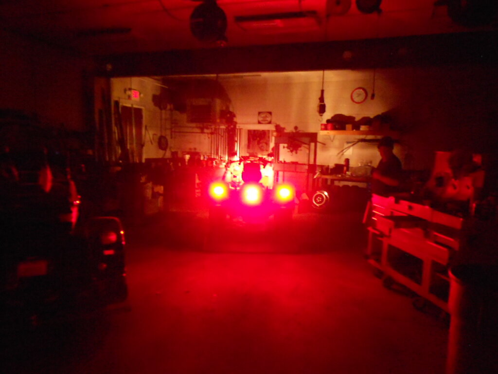

Wiring the trike for two taillights is not a big deal but Harley made changes in how they wired their motorcycles in 1996. So I had to do a little wiring work to make it compatible with the new led taillights that would also function as turn signals. I also had a used led tag frame that was once on my Road King that I wanted to use that has brake and running lights to give me better visibility. Everything can be unplugged easily if I ever need to remove the body. The body will be held down with four bolts.

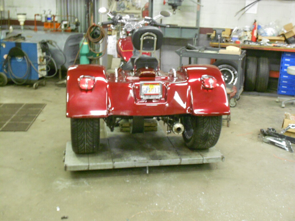

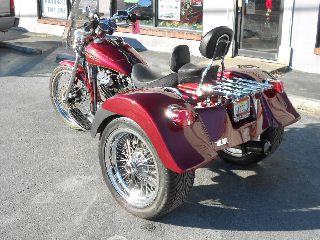

The body is back and installed along with installing the passenger backrest and grab handles. Luggage rack gets installed tomorrow after modifications.
This has been a piece together project done in 5 days. Most of the time was looking around the shop for bits and pieces to complete it.

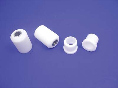

Did you use Delrin, or some other type of poly based material?
^...That is a great tip for anyone who still has one with rubber vs "solid" bushings, or for the future builder to add to his/her "hit list" for their build, (me).
It might also be a good upgrade for anyone thinking of upping their current horsepower, so as not to damage or destroy expensive factory castings...
Nylatron Swingarm Bushing Set from V-Twin 44-0671 paid $96.00 free ship.
