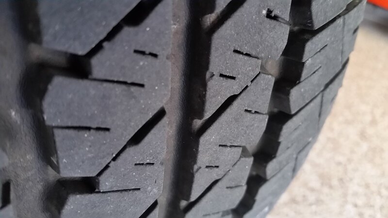

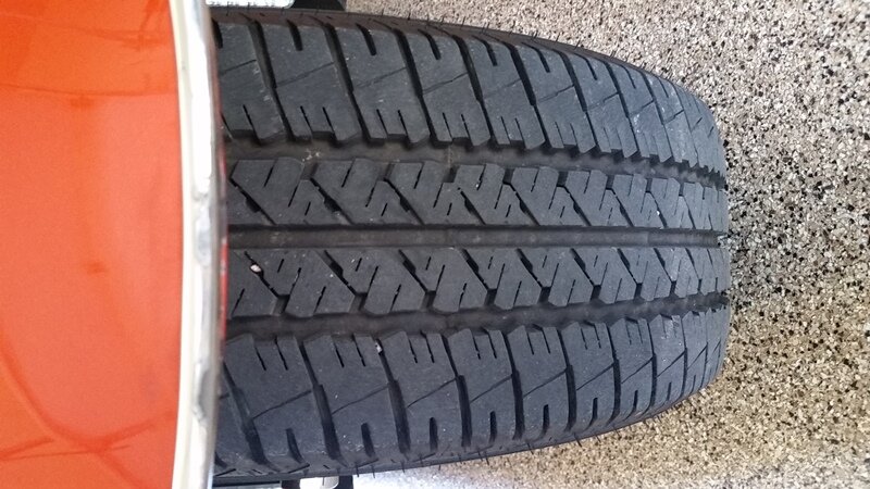

Front tire should be between 36-38 psi. If you run the original 42 psi in the front tire, you will wind up with cupping and the center will wear quicker. I know as not only was I advised to lower the front tire pressures by someone at TMS (who is no longer there) but, when I changed my front tire at 30k the measurements of the tread depth said it all--too much air pressure from the factory. I also lowered my front shock setting from the top to one lower and the trike rides better than it ever did.

I have run 41-42 psi up front ever since I had my Stallion and no cupping on my tire. This tire has 25,100 miles on it and hardly showing wear.
