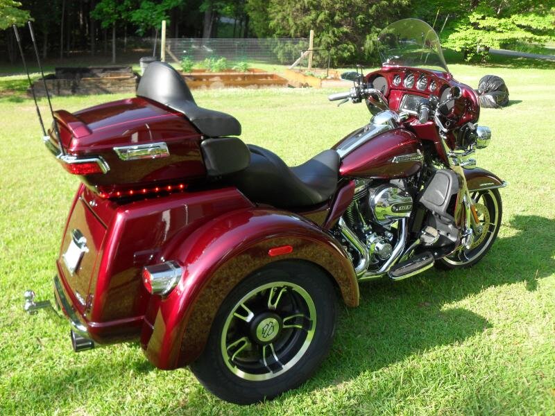

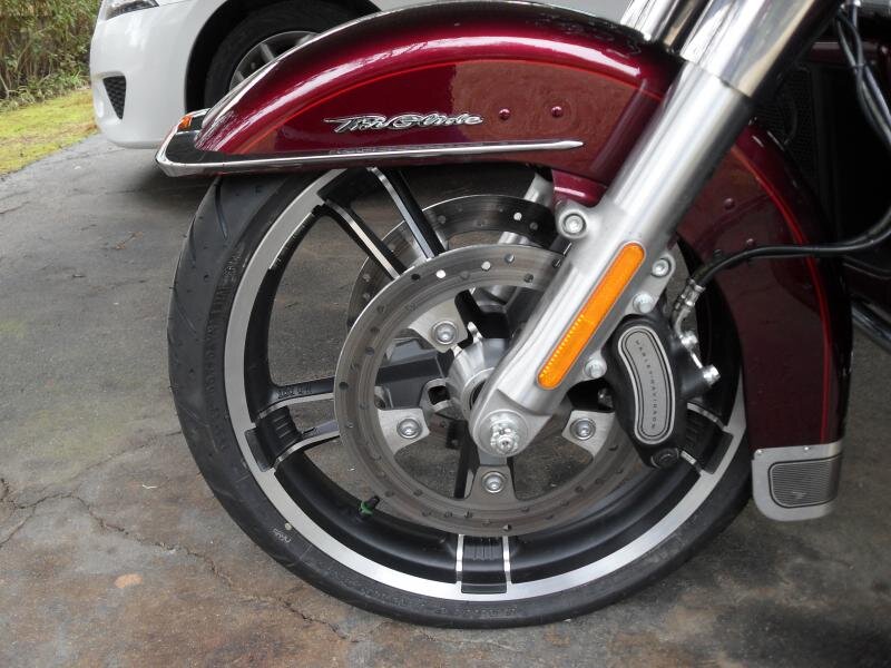

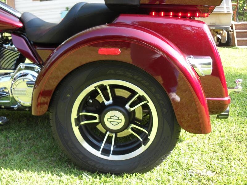

Here we go again...Freewheeler Enforcer and the Street Glide Enforcer rotors will not interchange...If you want chrome Enforcer wheels on your Tri Glide just buy the rear only and order the Street Glide chrome Enforcer for the front...
Got it. Here is the confusion...Harley says on line and at the dealership that that wheel (streetglide )# 43300336 will not fit a trike. Looks like it should say will fit trike if you change the rotors.
You are correct...I went through the same confusion...just to confirm the Street Glide front will fit our trikes...I took the chance and paid $450 for a takeoff just to see if it would...and paid another $450 for the takeoff Freewheeler rears...I stayed with the black because of my dark red...
