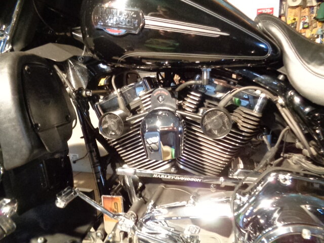

......I have a 2016 TG (water cooled)........Have not reviewed on this site yet because I put them on this winter and wanted to wait until I had some miles on them....put over 1000 miles on them now and I must say "They are great!"..........I leave them on most of the ride time and have had no more "hot pinging" in bad traffic (like I used to sometimes get in this devilish gridlocked Dallas road congestion)......They sound like mini jet engines when the trike is not running, but when the motor is on and the stereo too = I can't even hear them!
.....May I urge you to get the frame mount kit and these things won't budge from their mounted location when used after many miles (at least mine haven't,)......also, If you decide to go with frame mount kit, then I really, really, really suggest you take your gas tank off before installing these jewels as it will make the installation mucho easier!!!!! (4 bolts) = just remove it.
I'm sure the horn bracket mount is fine too but I truly have read where some claim the fans vibrated too much and came loose on the horn cover mount bracket. (won't happen with the frame mount kit I now know for sure!
....I originally just cut the plug off the fans and hooked up straight to battery....BUT, later I puchased an auxillary power switch kit HD #71400106 and hooked it to the dash switch in the kit so it would not be able to turn on when trike wasn't running (I did this after I walked out of the dealer one day and saw a couple sitting on my trike taking selfee pics as it was sitting next to the new bikes in front of the dealership)

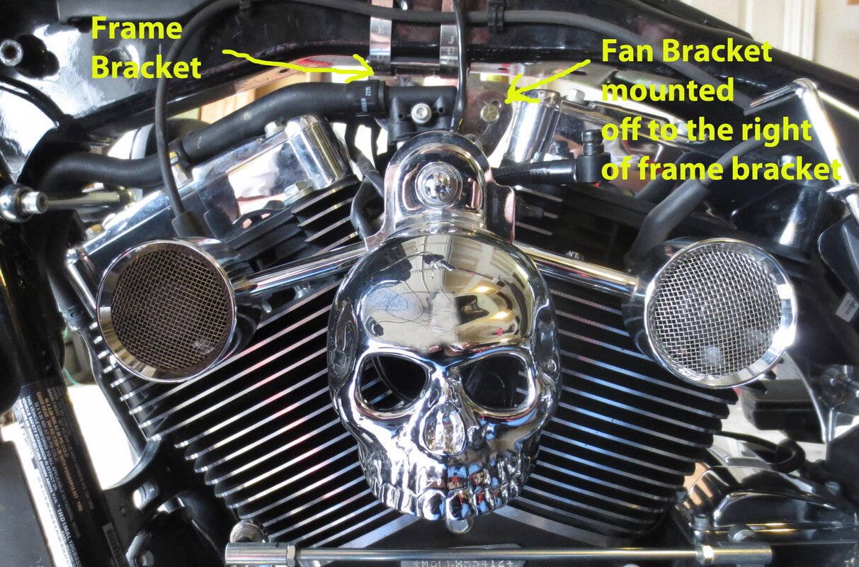

..........I don't know if yours is water cooled on not....probably is........When I got my kit with frame bracket mount, I found it confusing as the instructions were for an air cooled engine.
........With the air cooled engine you have more room to mount the fan bracket........not so with the water cooled engine as I noticed....you will have to mount the fan bracket off to the right side of the frame mounted bracket slot..........see pics (if there is another way, I couldnt see it) .....BE VERY CAREFUL with your fuel line and try not too fool with it any more than is absolutely necessary as it will take NO ABUSE or it will leak! (don't ask me how I found this out)

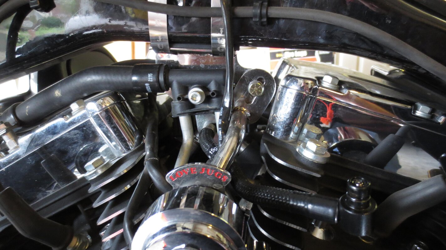

........anyway, here's a couple of pics below that may explain better.....(the skull horn cover I just added and replaced the stock horn cover)...The gas tank has been removed:
............Bought the Mighty Mites from Papa Zooks place here on this website = www.buylovejugs.com or phone #346-800-7946 (excellent product)

Regarding the Love Jugs "frame mount kit" on the Harley water cooled engine:
Oh, and i forgot to mention it.................but the horn bracket that the horn is originally mounted to..the the one that mounts to both cylinder heads and holds the horn......I recommend to just remove it so all the Love Jug brackets will clear everything nicely (that's what I did)........discard bracket mount and reinstall the bolts to the cylinder heads.
......Yes, I know it sounds scary to do this..........but its the only way I found to frame mount the Love Jugs correctly! ....I did much research before I removed the bracket (including talking to Papa Zook on this website forum) and its done all the time as the brackets' main purpose is to just hold the horn.
This is the bracket I'm talking about:
Horn bracket.jpg.....if you can figure out how to keep it on "AND" install the Love Jugs frame mount kit, then thats' great....I could not, so off it stays for me! (engine runs just fine and I do not notice any extra engine vibration after removing this bracket)
