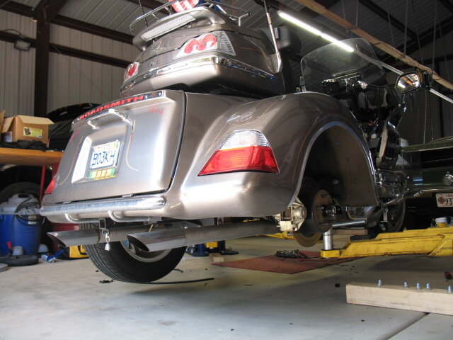

Before I got my two post 10,000 lift I would roll a floor tack under the pumpkin. Jack the rear end up and put some stiff arms under the rear tie down points then jack the front end up under the engine.
Now I just lift it like any other vehicle.

Reckon I could try that just to see whats under there.;)
