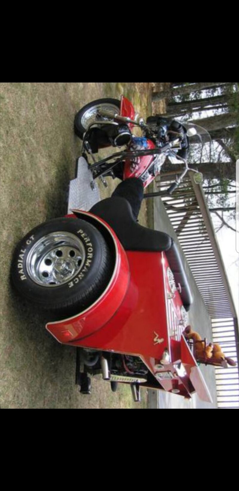

I'm looking to figure out best cam to go with a full automatic transmission in my trike build*
Building a 1914*
Case is getting machined*
I bought >>>>>>*
69mm CW crank 8 pin and balanced*
I beam rods. 5.4"
40x35.5. HP stage 1 port polished heads with dual springs , stainless valve*
Now i'm going order*
1914. 94x69mm Forged JE pistons with liners*
Looking at dual 40mm IDE carbs " Weber copies" ????
Looking for new rockers also ???*
What cam you all think go good with my auto trans and my combo ??*
I like drive like an old man mostly but do like to get on it and enjoy some power*
I keep looking and reading forums.s but not much on autos*
So far I'm thinking on maybe engle W110*
Please any and all advise helpful*
