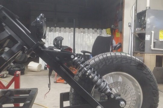

Steering is still harder than I'm thinking it should be. So I measured the trail and I'm around 5/8-3/4". Not what I was expecting. Since I now have the front coil-over springs it may make a difference. Up till now all I've had is 2 pieces of 1" square tube welded to the back of the links for the front suspension.

I doubt the coil overs will make any difference regarding steering effort. when you post the pictures, also post the frt/rear axle weights. If that front is heavy, that much trail could make for heavy steering. Then again, people pay good money for gym memberships just to build upper body strength! :D
Front axle is 500#, rear axle is 1620#, and both axles are 2120#. Those were taken with me on the trike going across the scale. I'm about 210#.
The only experience I have is with my own trike, which may not be enough to be giving advice. But I have 370# on the front wheel, with me on the seat. 2 inches of trail. I would not want the steering much lighter, but surely
would not want it any heavier. That said, I have never ridden another trike, so at this point do not know what is normal.
With your #'s I would be looking at ways to reduce trail.
Hopefully others will chime in with possible solutions....make sure to post a side view to show front frame/neck/trees and rockers, for those thinking of raked trees, rocker lengths etc.

From what I've been reading, more suggest 2-4" of trail is a good thing. A few say to keep it closer to 1". I did move the trail closer to 2". Here are a few videos of the first ride. Feel free to leave any comments/suggestions.

I'm thinking I misread your trail figures! it was 5/8 to 3/4" according to your post....for some reason I thought it was 5 inches! I wouldn't change that until more testing is done. If I recall correctly, ,Rex over in the VW forums, has said turning the handlebars from lock to lock while observing the top neck area...if it moves a lot, lots of trail, it very little movement smaller trail. Looking at the videos , maybe the relatively flat faced front tire, has to lift the front of the trike when you turn, whereas a more rounded tire face would not?? Overall looking good, and nothing more fun than a new machine brought to life!
If I recall correctly, ,Rex over in the VW forums, has said turning the handlebars from lock to lock while observing the top neck area...if it moves a lot, lots of trail, it very little movement smaller trail. 6r
some truth to that i have no idea where the numbers change...
but if u have, lets go extreme, zero rake there will be very little rise of the frame no matter what the trail is
but you could have a lot of rake and zero trail like this one and there will be a bit of rise ... not sure but i think the wide square tire doesnt help...

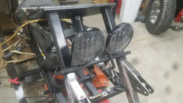

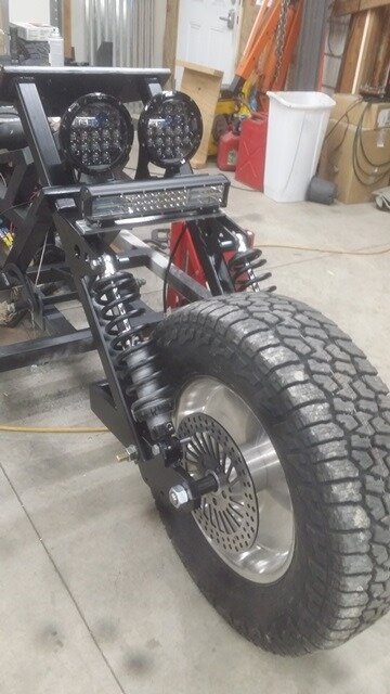

Mounted the headlights to check for clearance and to lay out the inboard holes for the brackets.
Tried these on a 12vdc battery on the back porch, lit up the bar 2 blocks down the road. I like!
Of course they'll always be on dim unless I am out in the country on a dark, desolate road by myself.:D

I too like to see the road and all around it if possible. I like the thin porfile of those lites, can I ask where you got them ?
I am still looking for new lites for my trike, at least head lights and very visible running light up front.
Nice work you've done, and it has been a joy watching this come together with all your work, you have to be feeling good about it. :D
Here is a link to the head lights. Several to choose from, mine are the 105 watts pair.
https://www.amazon.com/gp/product/B07JPXJD87/ref=ppx_yo_dt_b_asin_title_o00_s00?ie=UTF8&psc=1
This is the light bar that is under the head lights.
https://www.amazon.com/gp/product/B071S61K3G/ref=ppx_yo_dt_b_asin_title_o00_s00?ie=UTF8&psc=1
One night this week, I'll have them hooked into the wiring and align them best I can in the yard on the garage door. I'll know then how much the placement of the light bar works with the top of the front tire.
​31785
The mounting of the front lights doesn't seem to interfere with the top of the front tire. Will check it again when I get the front fender made and mounted.

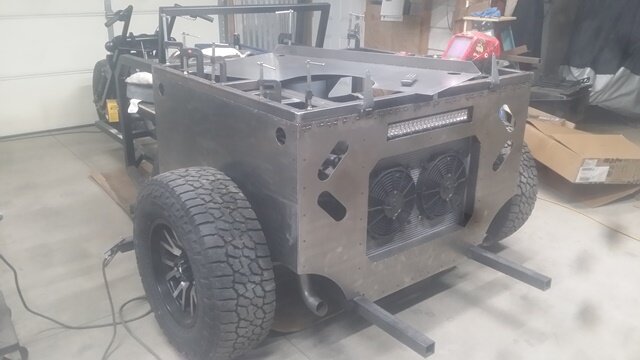

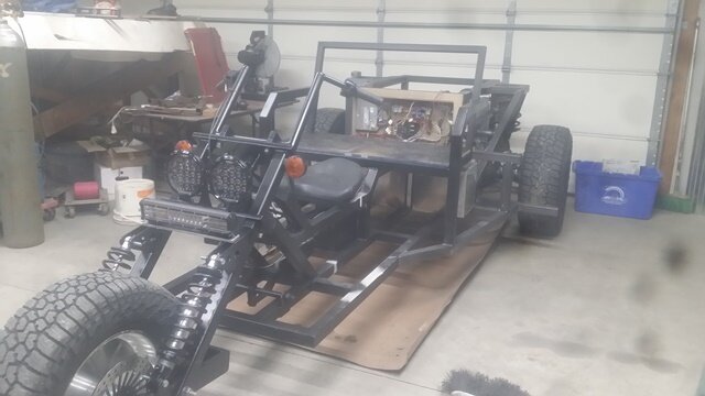

Had a fairly productive weekend. Re-did some of the frame work behind the rear seat to support the sides of the body. Added a bit of structure for the rear body panel for the tail lights and back up light.
When I added the rear seat framework, it really started to come together.
The shop hound isn't much help. No, she doesn't have led eyes.

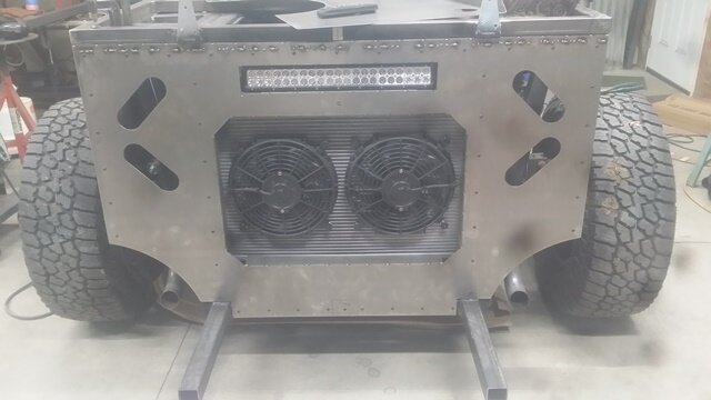

Thought I had it all laid out right. Forgot to move the pattern on the screen down to where the metal actually was on the table. Had a miscalculation by about 2 1/2". Oh well. Guess I'll be doing some grinding.
​34169
A beast indeed! Coming along nicely.
What are the plans for the rear frame extensions, and the panel laying on top of the motor box?
The panel on top is the right side. I ran out of time yesterday.
The frame extensions will probably get cut off about 6" past the rear sheet metal with a hitch installed and a small platform/step. Gf is a bit on the verticaly challenged side so there needs to be a step.

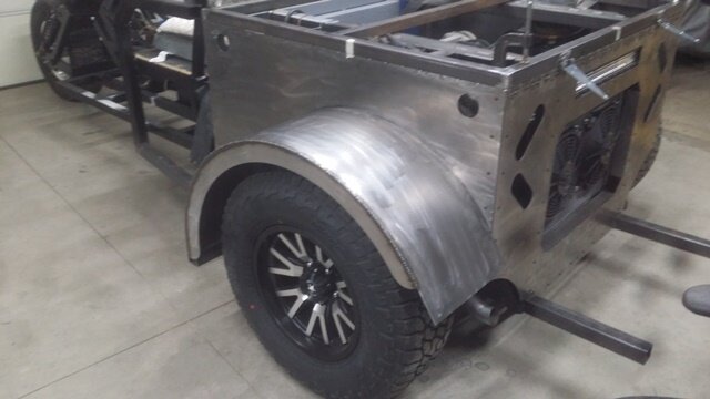

Worked on a pos Harbor Freight English wheel for most of the day Friday. They SUCK!

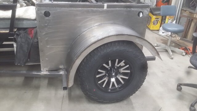

Anyways, between Mardigras and family, I finally got one fender on. It needs a bit more attention with some shrinker treatment. Right now its just being held on with three pop rivets, but I'm feeling its going in the right direction.
Wasn't thinking about how metal reacts with heat...until it was too late. About 15 minutes with a shrinker, it'll be fine.
​35191
