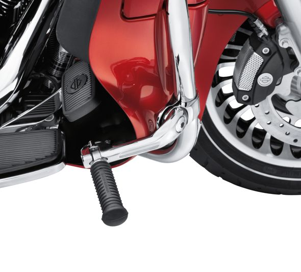

....You may wish to consider (along with the proper air breather of course) getting the HD Long Angle adjustable Highway Peg Mount Kit
(Part Number 50829-07A) and add the front pegs of choice.
.......I got these just to have highway pegs originally so I could stick my feet in the air like everybody else....BUT, after I installed them I found that by dropping them lower than most do (but a little higher than the floor pads) = It now allowed me to place my heels on the floor pad and rest the front of my boots on the highway pegs while driving normally..........................Not too usefull for resting my feet high in the air, but was excellent to relocate my feet position while driving....This allowed my legs to totally relax and open much wider while riding and eliminated all fatigue normally experienced when feet are on floor alone....this also helps right leg clear air breather FOR SURE while riding!
.........You may likely know all about this stuff anyway, but I just thought I'd pass it along.
..........By the way, I am 5'6" tall and very aware of possible leg comfort issues on the 2016 TG.............(I'm sure its the same for your TG too)
...raise hwy pegs location a liittle higher than in pic below which is just a HD website part pic:
