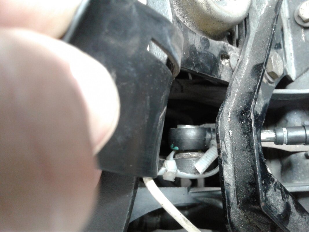

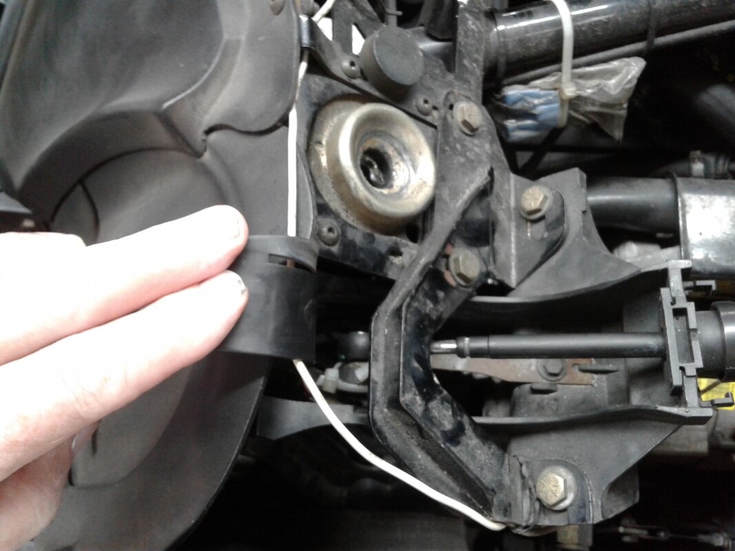

Victor i found my wife's problem. The shifter end of the shift cable the bushing was completely gone. The cable end loop stayed over the post but there was about a 1/2 inch of slop so it did not hit the proper gears when moved. The cable could of easily come off making for no ability to change gears at all.
I made my own bushing out of 1/4 in rubber hose 3/8 in long. Put it on the post on the shifter and then slid the cable loop over the bushing. Because the factory bushing has some kind of locking mechanism to hold the cable on, my repair I had to devise a way to keep the cable from sliding off. I took 2 plastic wire ties and made o loop around the cable securing it to the shifter post. Works great.

Victor just so we have our terms correct, when you say wire are you referring to the shift cable? The shift cable is a good 1/4 thick end with a loop and the cable itself runs in a sleeve. Sorry no photos
The cable attaches to a lever that comes out of the side of the transmission. This lever is located on the left side of the transmission. It is right in by the master cylinder. The cable is mount similar to what you see at the shift lever but the connector appears to be more rugged.

With your guidance I was able to track the problem down it was the cable came loose by the gear I put it back and use Loctite and hopefully it won’t happen again
Gear
Sorry I try to put some pictures on of the problem but I had no luck
Sorry disabled veterans heavy medication so I feel better I’ll try again
