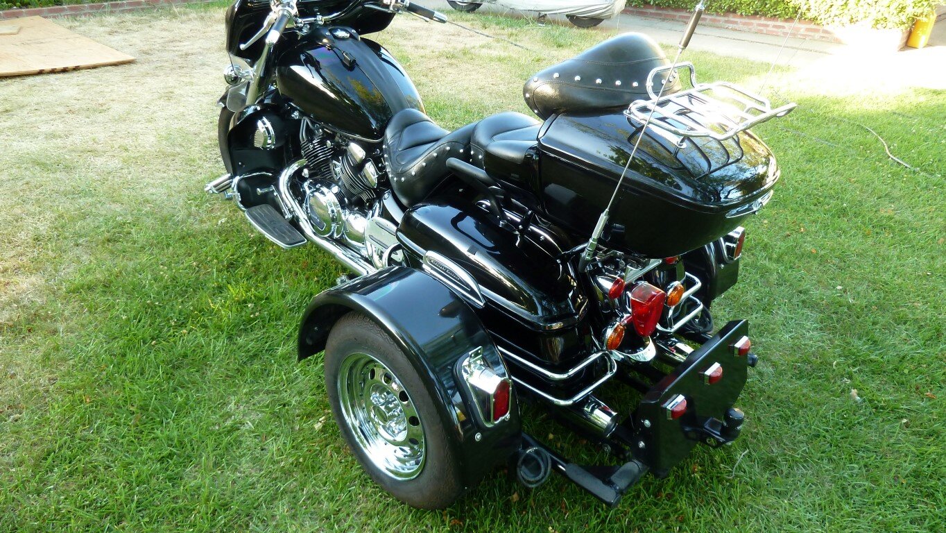

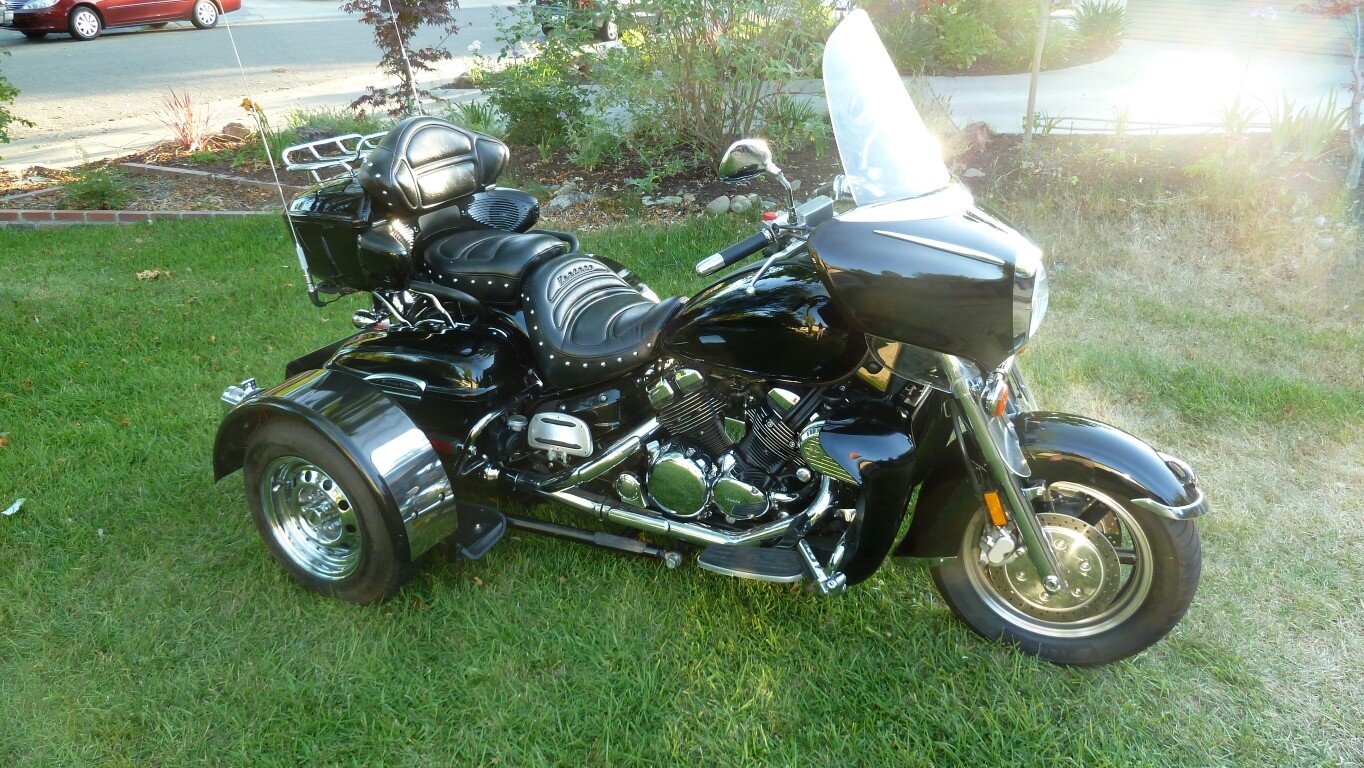

I just did mine and it'll pro'bly be too late for your project, but here's what I found. Don't believe the installation manual completely as they've never up dated it. They have a couple of installation videos on their website. Watch them completely...twice. In my case I had to go to turn-down slip-ons to keep the exhaust from hitting the back cosmetic plate... an '06 classic. Newer models are all the way across... Talk to the tech if you have any questions. Lots of great info, and they share. Hope yours worked out for ya...2014-06-05 18.06.44 (Medium).jpg2014-06-05 18.07.30 (Medium).jpg2014-06-05 18.06.44 (Medium).jpg2014-06-05 18.07.30 (Medium).jpg
