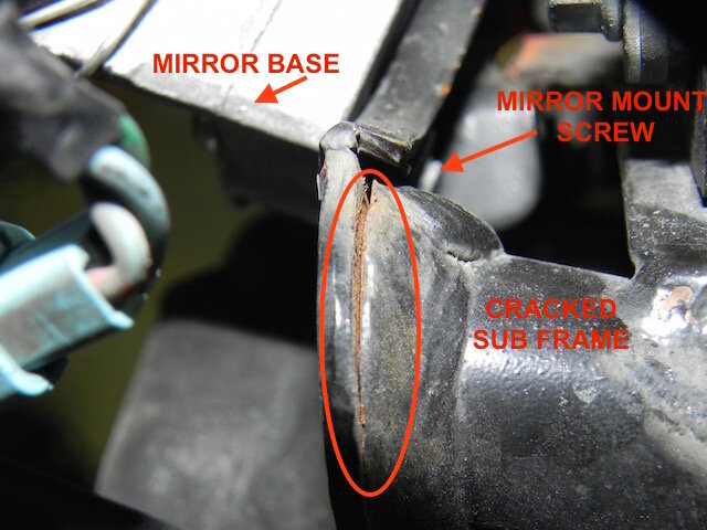

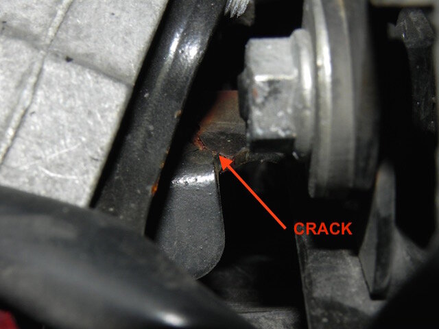

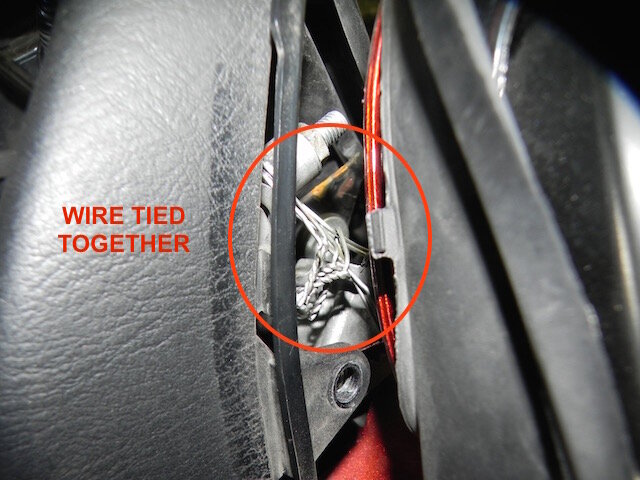

Now to explain why I said to ignore your mirrors in doing this. Many years ago while I was still a tech we had a bike that had a HORRIBLE shake in the mirrors (the stripes in the road looked like 4 sets of stripes it was so bad) & a vibration in the bike itself. We went over the bike several times over a few months of repeat visits by the customer and could find nothing wrong or out of the ordinary (the felt vibration in the bike was determined to be "typical" vibrations that some GL's have).
We had a dealer drop off a brand new Goldwing early for a conversion (demo for their floor), so we removed one of the mirrors from the new motorcycle and installed on the customers trike. The new mirror was vibration free & the images behind the bike were crystal clear while the other mirror has so much vibration you couldn't see behind you. The bushings inside the mirror housing were worn out and had been causing the primary issue for the customer all along (he didn't notice it as a 2 wheeler for a few reasons that aren't worth diving into).
I'm not "pointing the finger" at your mirrors, but am saying it's worth taking a look at on a bike that's 8 years old (ESPECIALLY if it has wind deflectors mounted under the mirrors).
