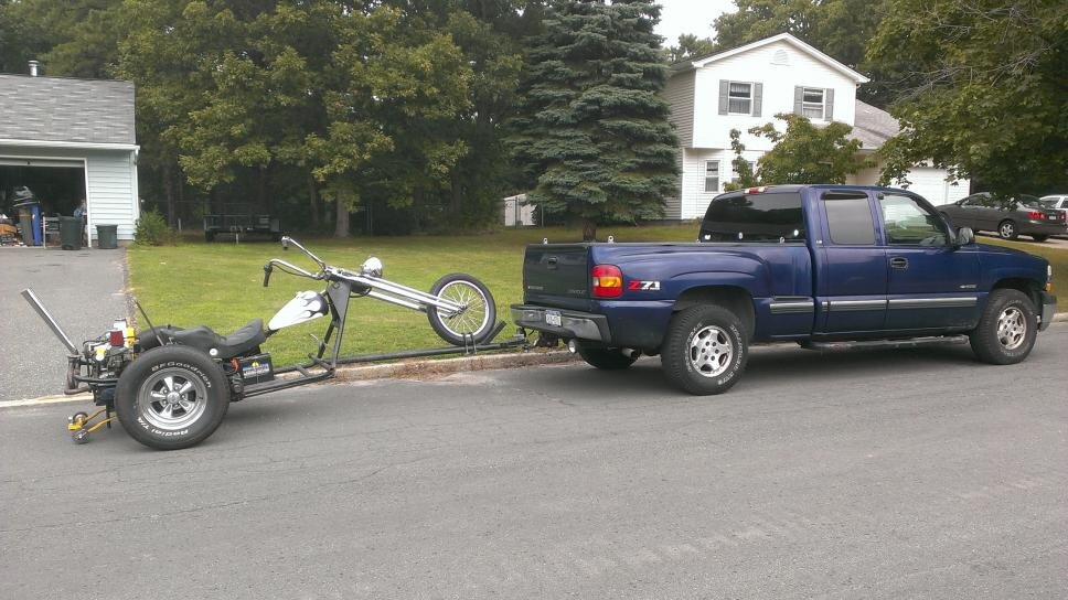

I've only travelled short distances, but previous owner says he used to tow it hundreds of miles.
With weight in back, I have no problem lifting front off ground. In my case, long bar is actually attached to trike frame with wheel bolted down on it. My biggest problem is how low rear hangs. I need to actually get a lower hitch ball bracket eventually.
