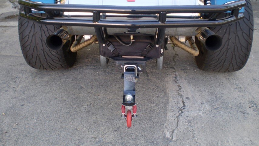

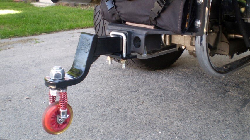

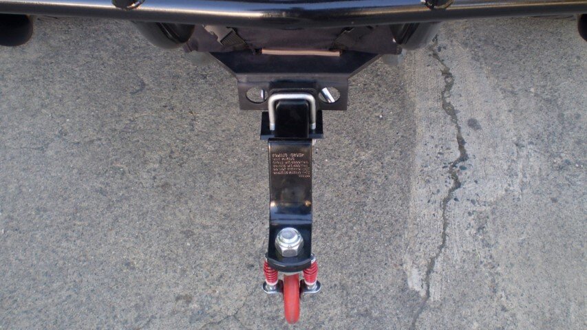

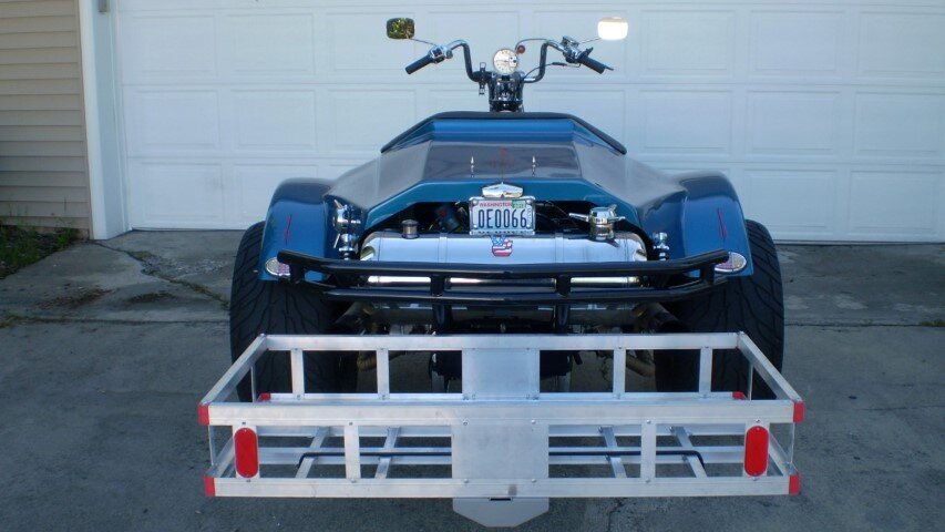

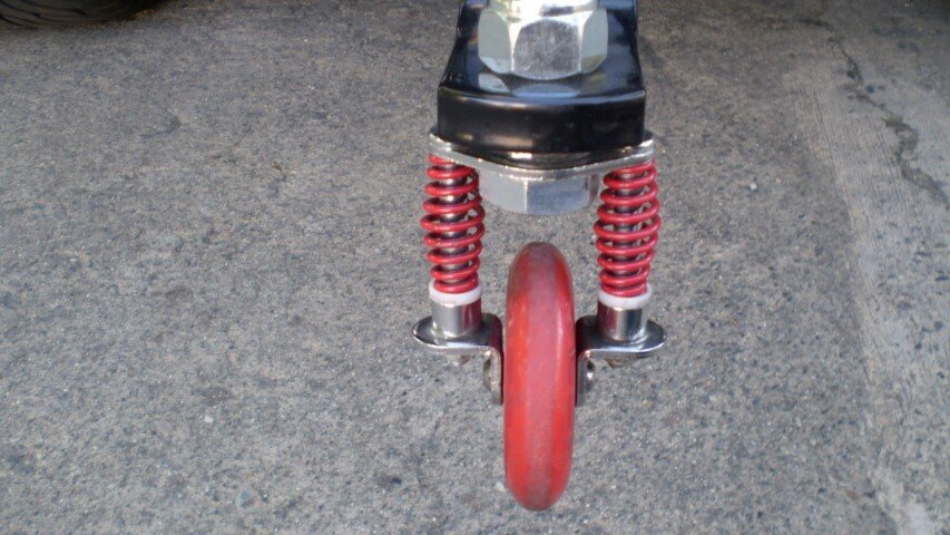

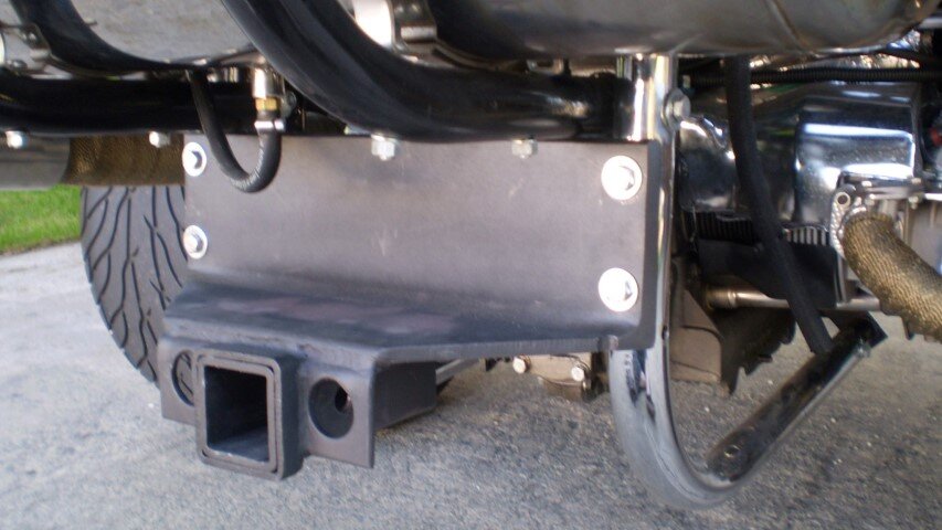

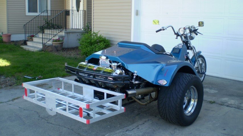

Here are some pics of my newly made hitch. 1/4" 6x6x16" steel with a 2" hitch welded to the bottom. Works great and super tight with no wiggle, when using a hitch to receiver U-bolt tension tool. I will be adding a wheel to the bottom/back of the rack as well. Light weight rack is perfect for taking a small cooler and some lawn chairs, for that cruise to the lake or a car show! Cheers!

nice work
good looking hitch......like that anti rattle feature, that rack won't be tipping and jumping like so many do!
