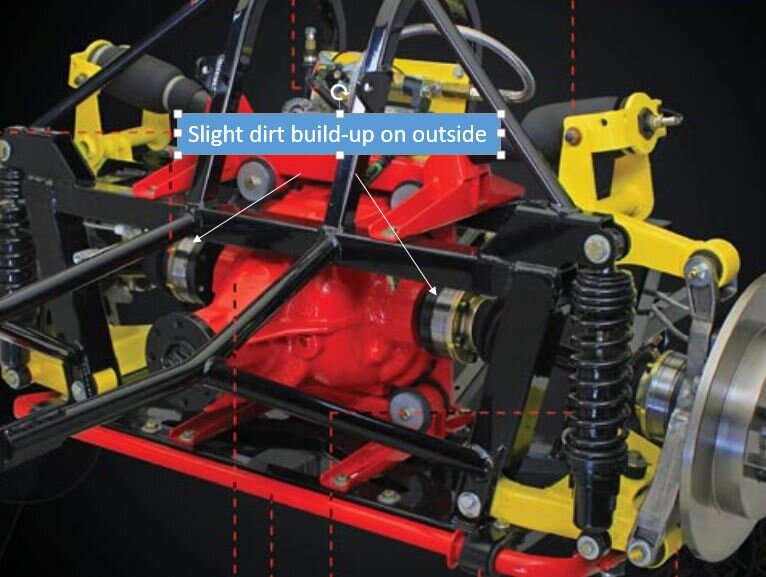

OK, I see below ….. where they used to use the 8", with pumpkin in a SA set up, now using the 7-1/2" integral style (like was in my '85 Thunderbird) modded to work with IRS.
Website says 7 1/2", looks just like this but not as pretty. Leak (if there is one) has been there for awhile as there is dirt buildup on the outside of the "silver things" (see picture) but most of it being at the bottom rear of the "Pumpkin" and the support rails underneath. As I stated earlier I saw what appeared to be oil around the edge of the gasket, maybe it just didn't get a good seal. Will check fluid level after I get the correct size allen socket, hopefully I don't have to remove too much stuff if it's just the cover gasket. Any thoughts on whether removing the body will allow easier access or am I stuck ripping the whole rear end apart?

OK, yeah, just a rear cover on those. Still a Ford rear, but used in a lot of cars and small PUs, but it's been modded to work with IRS.
The '90s era (like '89-'97) V-8 Tbirds used a 8.8" rear with the IRS set up, not sure, might have used 7.5s with V-6? I have two of the V-8 cars, never looked under a V-6 T-bird but Rock Auto shows me some V-6 cars used 7.5s. My '85 Tbird was a 302 V-8, but used a 7.5" SA rear.
I'd still just clean well and check fluid level and monitor unless it's a big leak. I first thought you had a gasket leak in a different place, but there at the axle points, it's axle seals and some weepage isn't unusual with time. To replace seals there, the CV axles will have to be dropped at pumpkin end and there'll be seals in the housing where shafts exit.
Also, look for a vent hose and make sure not kinked. Might just be a short lightly spring loaded vent cap and no hose. It'll be up on high side someplace. Fill plug is often just a square 3/8" or maybe 1/2" recess for a ratchet to fit.
