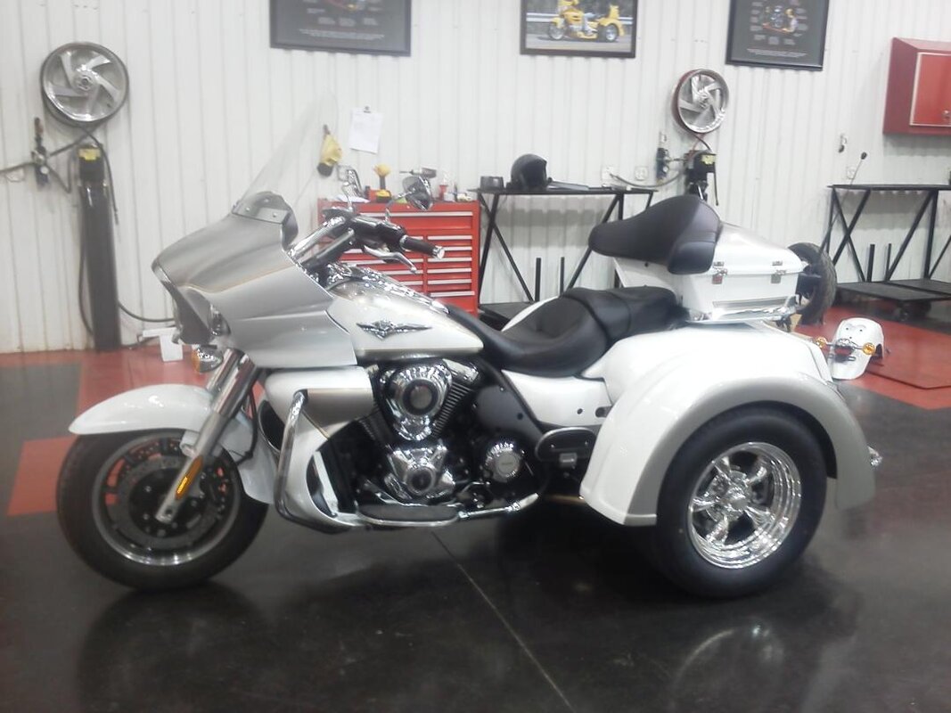

Hey Chappy, was that Kaw white? I was looking at a couple at Sparks, but its been a while back. The white one was sure a sharp looking trike. Sorry you had problems, but glad your ok. Hope you get it back soon.
Yes Rod69. It has silver accent.
