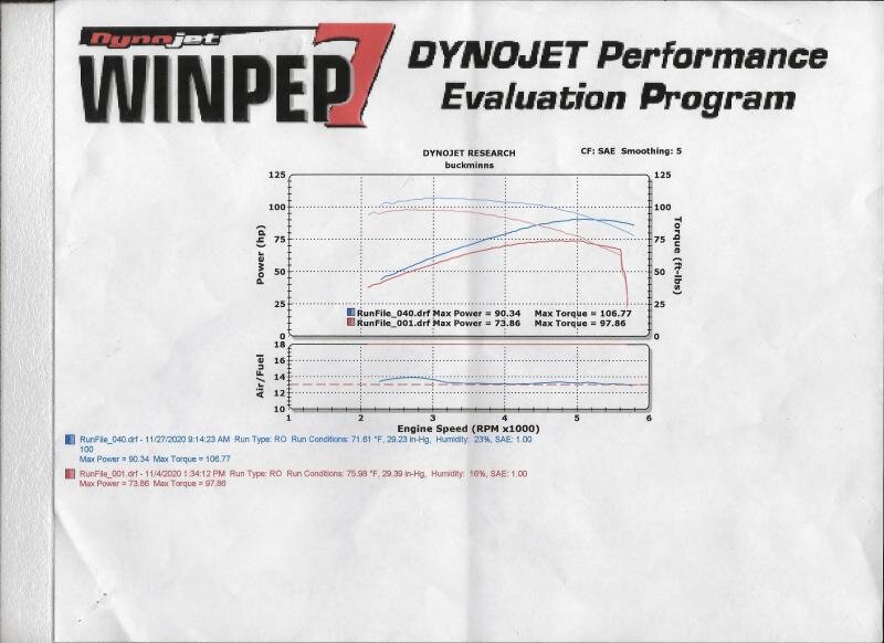

I have done several mods on my 2017. First was the DK Customs oil filter relocation kit since I do my own service. Next was a lift kit from RJS Originals then was the Po Action shocks from DK Customs. I installed a set of Khromewerks 2 plus 2 wide sweeper handle bars and this improved the steering a bunch, since the wife and I tow a trailer on long rides I had a S&S 465 cam S&S lifters and a TTS tuner with a complete dyno tune along with a Fulsac sportpipe head pipe. It now has the low end it should have came with from the factory.
