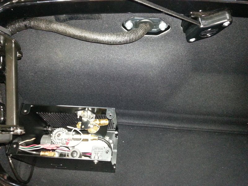

While visiting Kevin from DK Custom I had the MacAir System installed on my 2015 FLRT. I had the opportunity to give it a good test yesterday on a pretty rough road. I quickly learned that as little as 2 lbs. can change the ride. Been riding HD touring bikes since 2007. Have about 130,000 miles on the air shocks and always thought I knew just how much air I needed for a given load. Found out I didn't. Rough road with just me on the FW. 22 PSI was what the bike wanted. 20 was too soft. 25 was too hard. And I swear that the extra air in the system from the hose(s) makes the ride a bit more, how would I say it.... plush?
They system does take up some room in the trunk (10% ? less in the TG). In my case no more than the small compressor I always carry with me anyway. Instillation on the FLRT is pretty simple. Except for one step I see no reason it could not be done by one person. I never thought of putting an air system in before as the price was far more than I was willing to spend. The MacAir is allot more affordable than other systems.
Anyway, that's my 2 cents....
System without cover installed....
