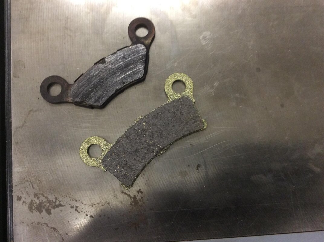

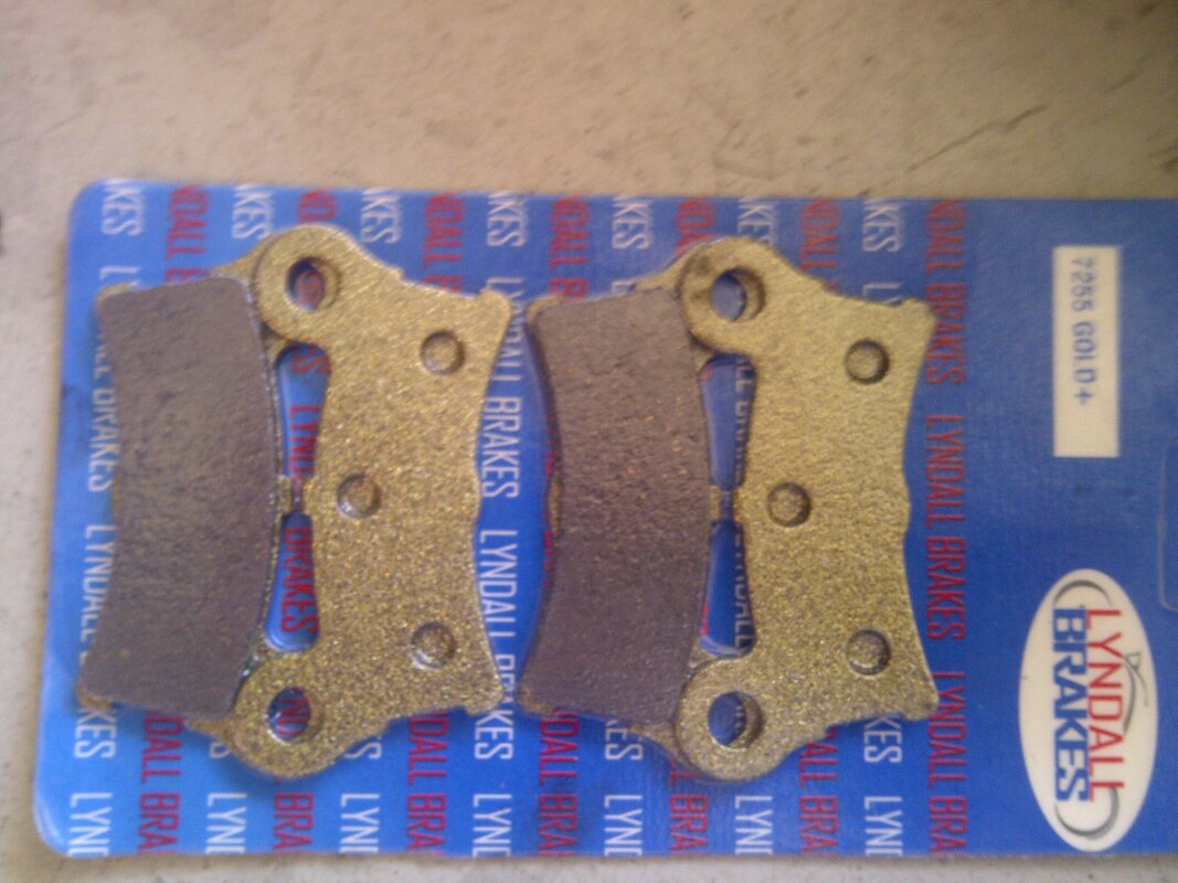

OK, sat down this morning to install the Lyndall 7255 pads, and they are different than the OEM HD pads. No lit included that says anything about this...
Anyone else seen this?
The pads look COMPLETELY different... the friction surface is slightly smaller, and there are ears for the bolts, while the OEMs do not.
I attached a picture

OK, long story short... I just looked at the HD website (guess I should have done this first). The pads I got from Lyndall look just like the ones listed for the '09-'13 TriGlide, HD part# 83911-09B, while the ones for the '14, HD part# 41300033, look completely different.
I guess I will have to contact Lyndall on Monday and get these exchanged. Hope they have the correct ones, or I will be looking to EBC!
You are correct, you have the pads for the 09 - 13 Triglide, 14 and later are a different pad.

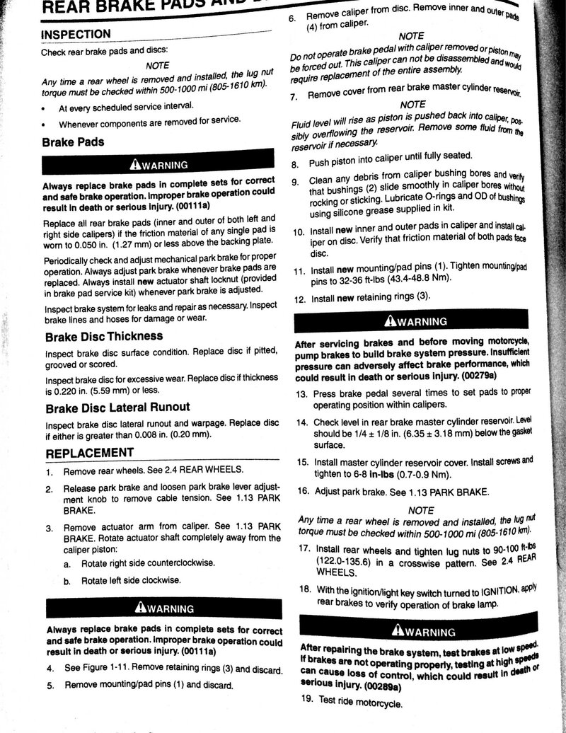

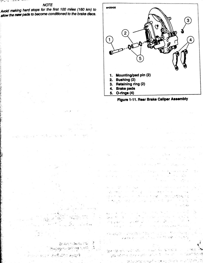

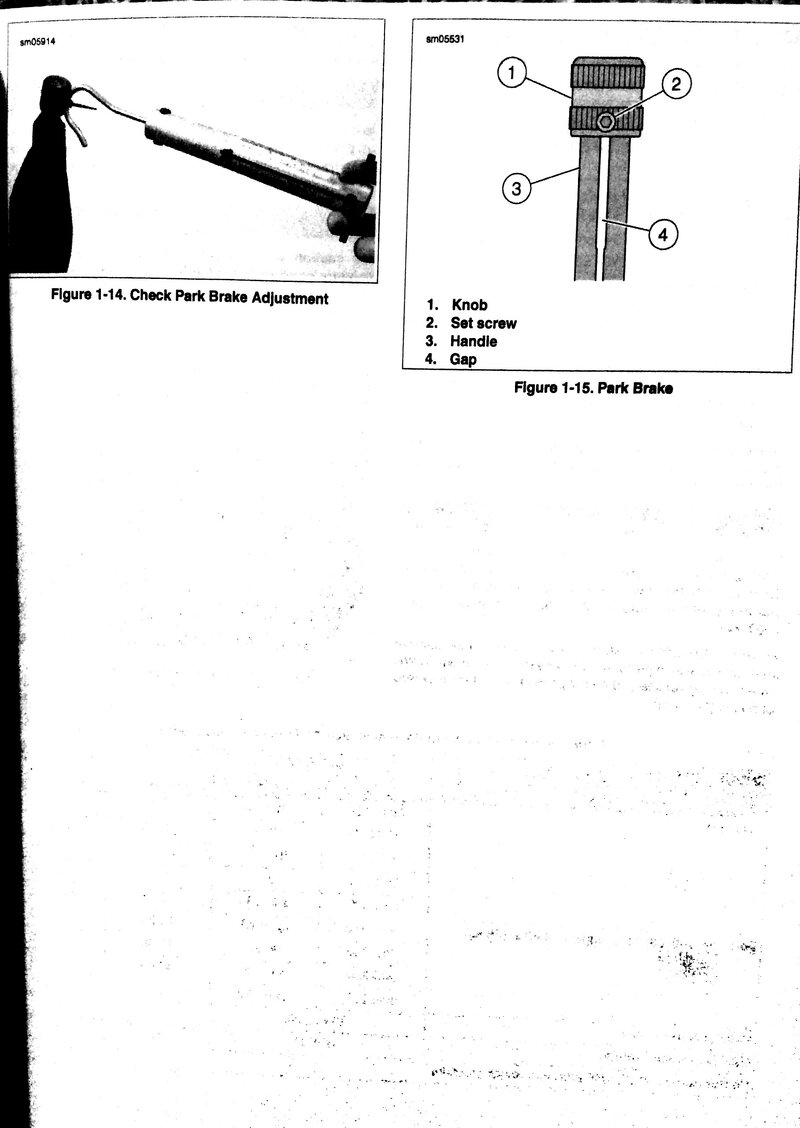

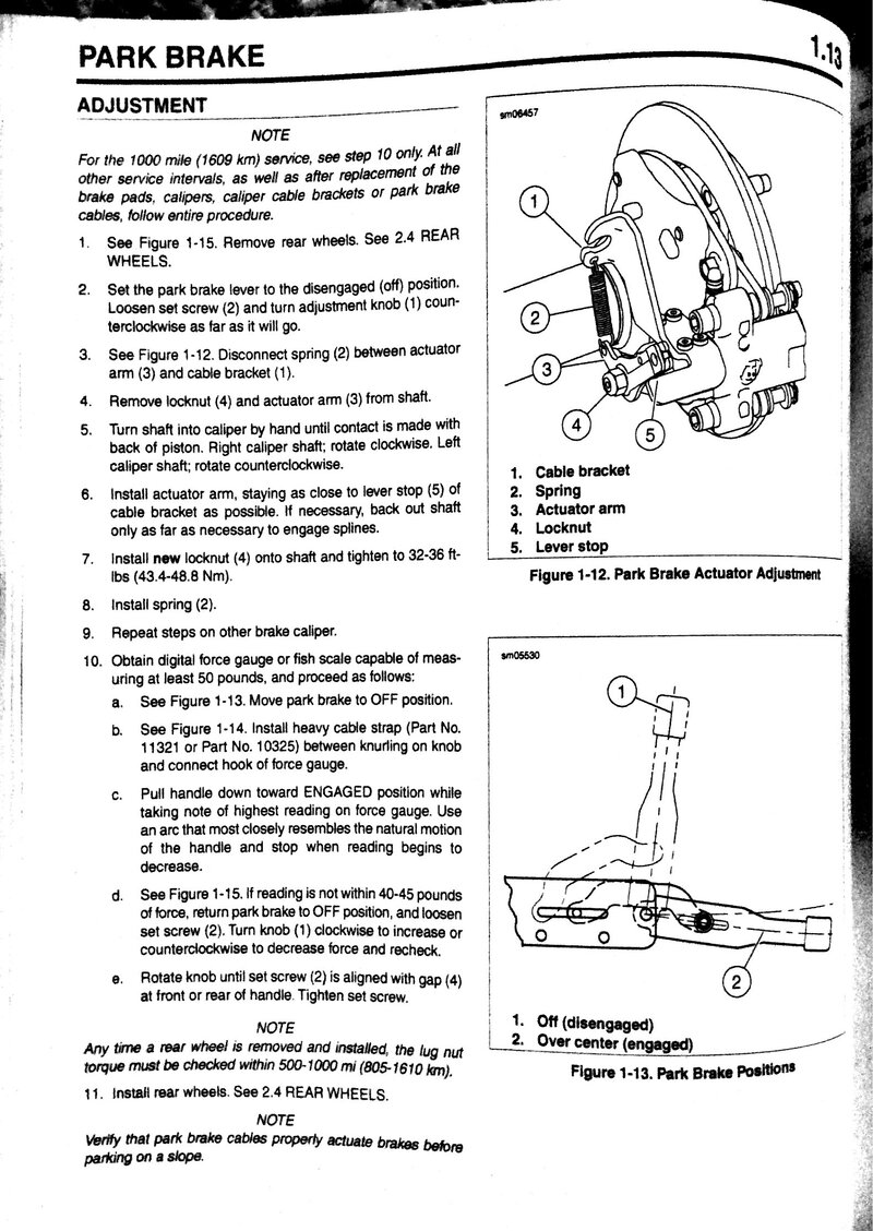

Here are some pictures with the steps to do the job. Let me know if you are unable to blow them up and read them.

Thank you very much, they printed great.
