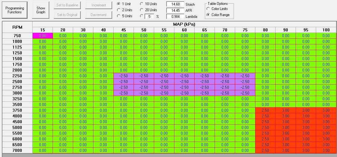

  1. when I open the Spark Advance the graph is filled in for the Map you suggested. Do I simply subtract the 2.5* from the number in the cells that you have indicated?
  2. Also used Cam tool to set IVO at 5, just slightly earlier than the S&S 557. IVC set @ 3 per your directions. S&S opens 6.0/26.5 & closes at 38.8/12.4
  3. Only thing left to do is set the -2.5* in the proper cells. Your graph shows all 0.0 except for the adjusted cells.
A little help would save me some time. I have read your TTS/D and the TTS manual but alas the fog is still there preventing clear vision.............
Wiz,
Sorry...
The table I posted was another view. You can find this view by opening up your timing table then, at the top of the screen, open the "Tune Comparison" menu and select "Compare edits to original". This will show you any edits you made to a table.
Select all the blocks I did in the middle of the timing table. It's easy to select.
It acts like a spreadsheet, just click on one cell and drag your mouse. After highlighting all the proper cells go back to the Tuning Comparison menu and select "Working Calibration". You will notice all the cells still highlighted.
Your Units will be set at 1. 1 unit = .25 of a degree. So click "Decrement" one time to lower or retard your timing .25 of a degree or click Decrement 4 times to retard 1 full degree.
After you remove the proper degrees (2.5) go back to Tune Comparison and Compare edits to original. It should look just like my screen shot less the high RPM changes. Do this again for the other cylinder.
Save the file as Test Tune-timing-001
Flash your bike and test the bike for knock retard.
Sorry...
Select all the blocks I did in the middle of the timing table. It's easy to select. It acts like a spreadsheet, just click on one cell and drag your mouse. After highlighting all the proper cells go back to the Tuning Comparison menu and select "Working Calibration". You will notice all the cells still highlighted.

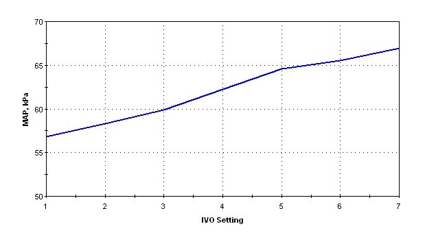

Think this is what you are asking for.
Perfect
Your first break is 3 so test both 3 and 2 for the best idle results then Vtune. If you change it again you will need to start over on your VTune runs.
Perfect

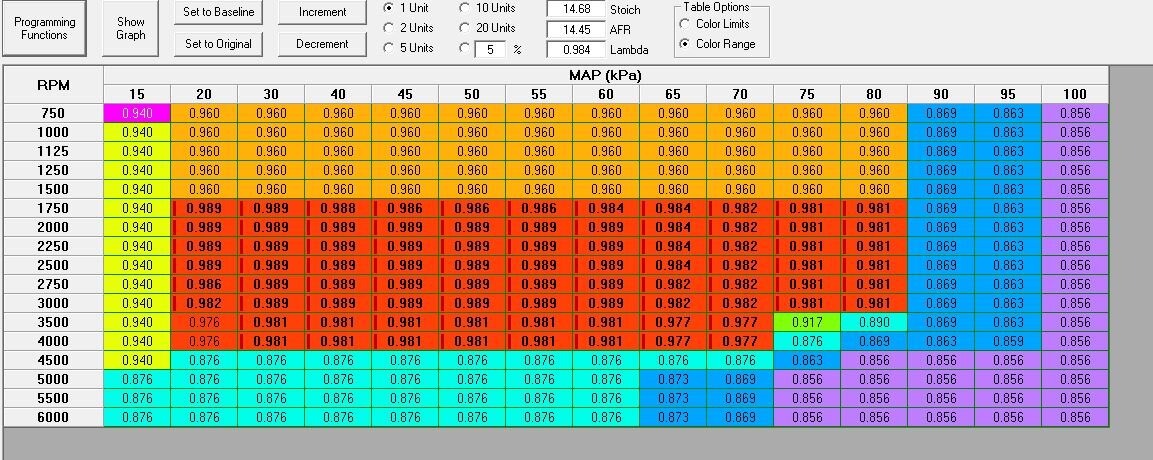

Attached is my favorite Lambda scale to date. You may experiment after your trip with what suits you and your riding habits.
It may not be for everyone but I believe the 960 will keep you a bit more cool and give the bike a little more off idle. It also takes the 02 sensor out of the adaptive learning adjustments so there is consistency down low.
