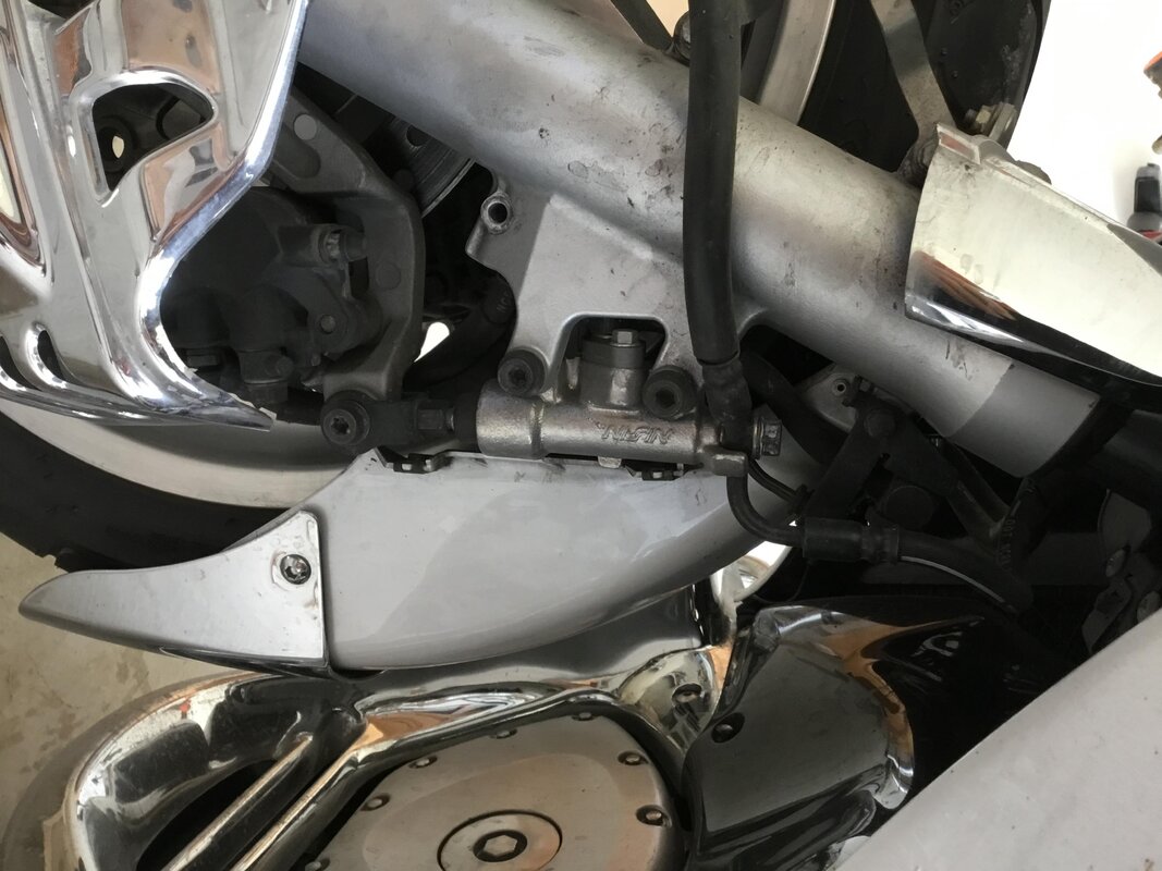

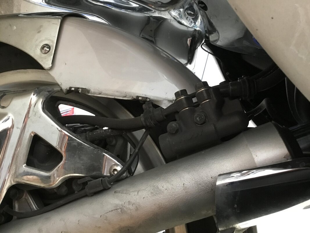

OK, found the AD, now to disable it, would a common metal washer inserted into the recess in the lower half disable it?
The picture shown is not the anti-dive valve. That is the secondary master cylinder.
The anti-dive valve is located on the leading edge of the left front fork.:cxtv:
